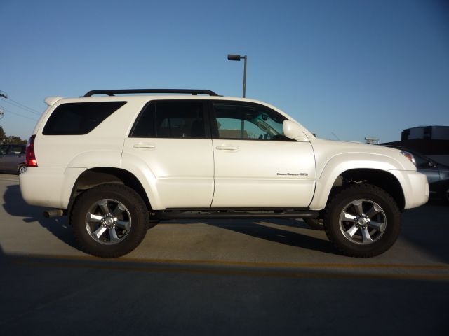

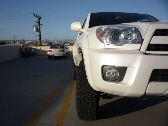

Here ya go... Just happened to take these today. Another member wanted to see this lift as well.

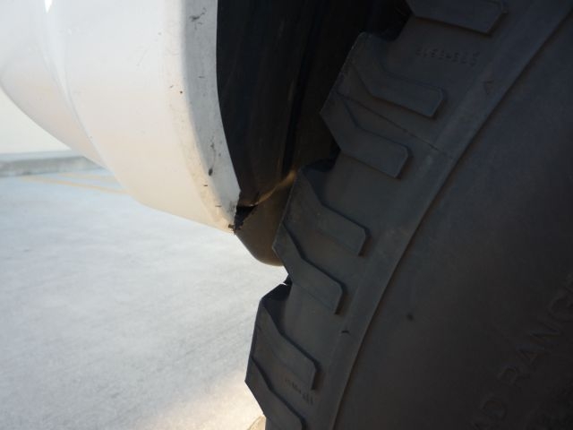

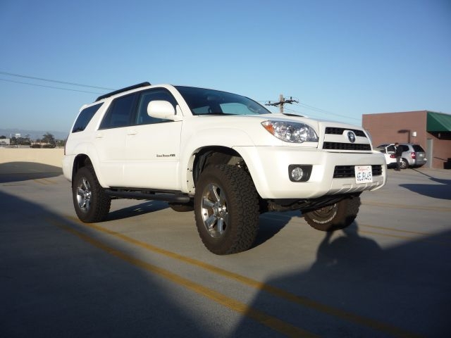

Here are a couple more. One shows a closeup of the fender trimming.
