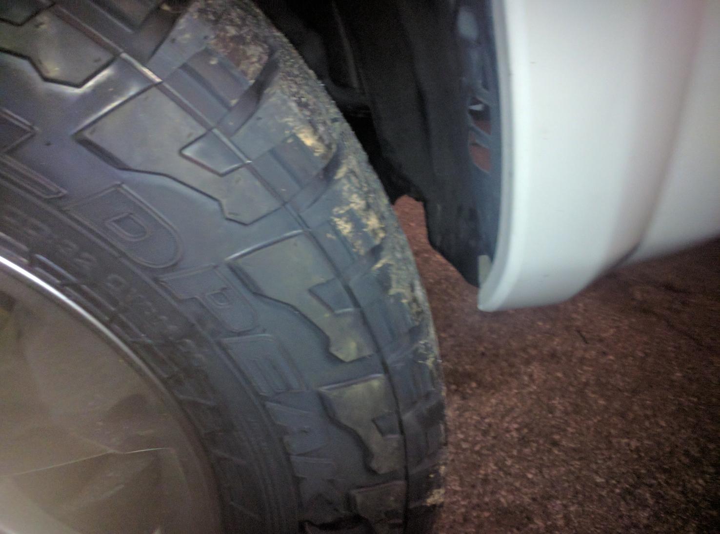

Removed mud flaps and moved the splash guards about 1" forward. Haven't have any rubbing at all.
My setup is in my sig. I rubbed the front well, just pushed it forward. After my alignment I am just barely rubbing the hump on the mud flap in reverse full lock. Not enough to make me want to lose the flap. Might mold it a little with a heat gun.
How did you move the liner forward?
There are 3 screws on the underside of the front well/bumper that hold it in place. Undo the screws, and push the liner forward a couple inches. Using a driver, reseat the screws to hold the liner in place.
The corner lip of the bumper may rub too, so if you take a razor to it, it'll do the trick. It's a dark pic, but if you look at this and compare it to yours, you'll see what I did.
