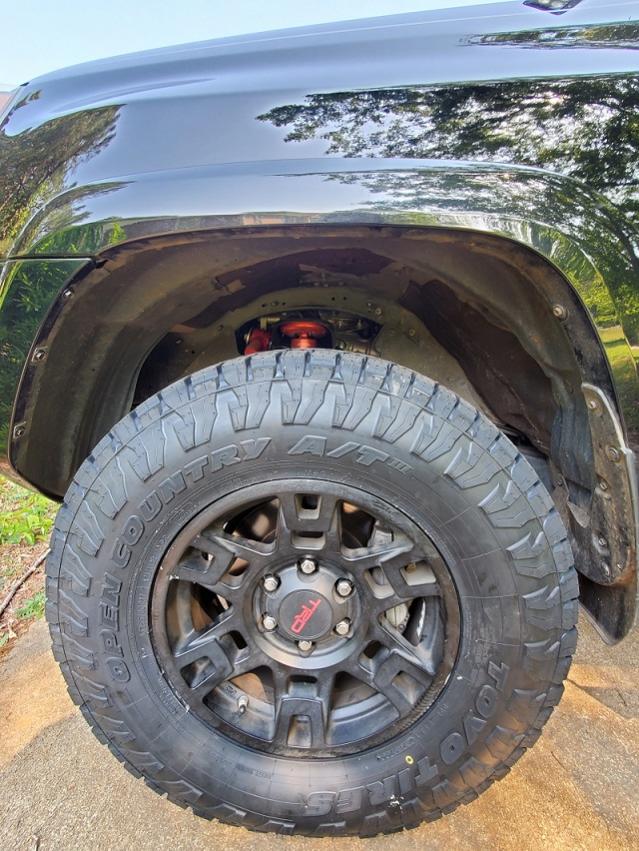

These were my 2nd choice as I could not find Ridge Grapplers. So far I'm liking how they drive and hum is barely noticeable. Much less than the mud tires I had before. No BMC and no rubbing.
Toyo ATIII 255/80/17
