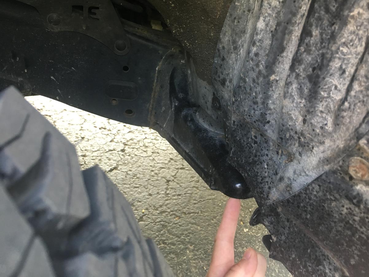

Right, i'm "technically" backwards. Though, when I had my alignment done at 4.5* I had zero rubbing at the mudflap, then with 3.5 I had a ton and had to do a body mount modification, which shows that more caster angle does increase rear body mount clearance.

203253d1462672072-5th-gen-4runner-will-my-tires-285%92s-rub-here-some-things-consider-img_0415.jpg
Stolen pic.
You can chop the mount, trim the flap....or get UCA's and adjust the cams to move the wheel forward (with 3'' you should) or do it all! I took the center out of the flap because I like the look and protection down the side. I used SPC UCA's and like them!
