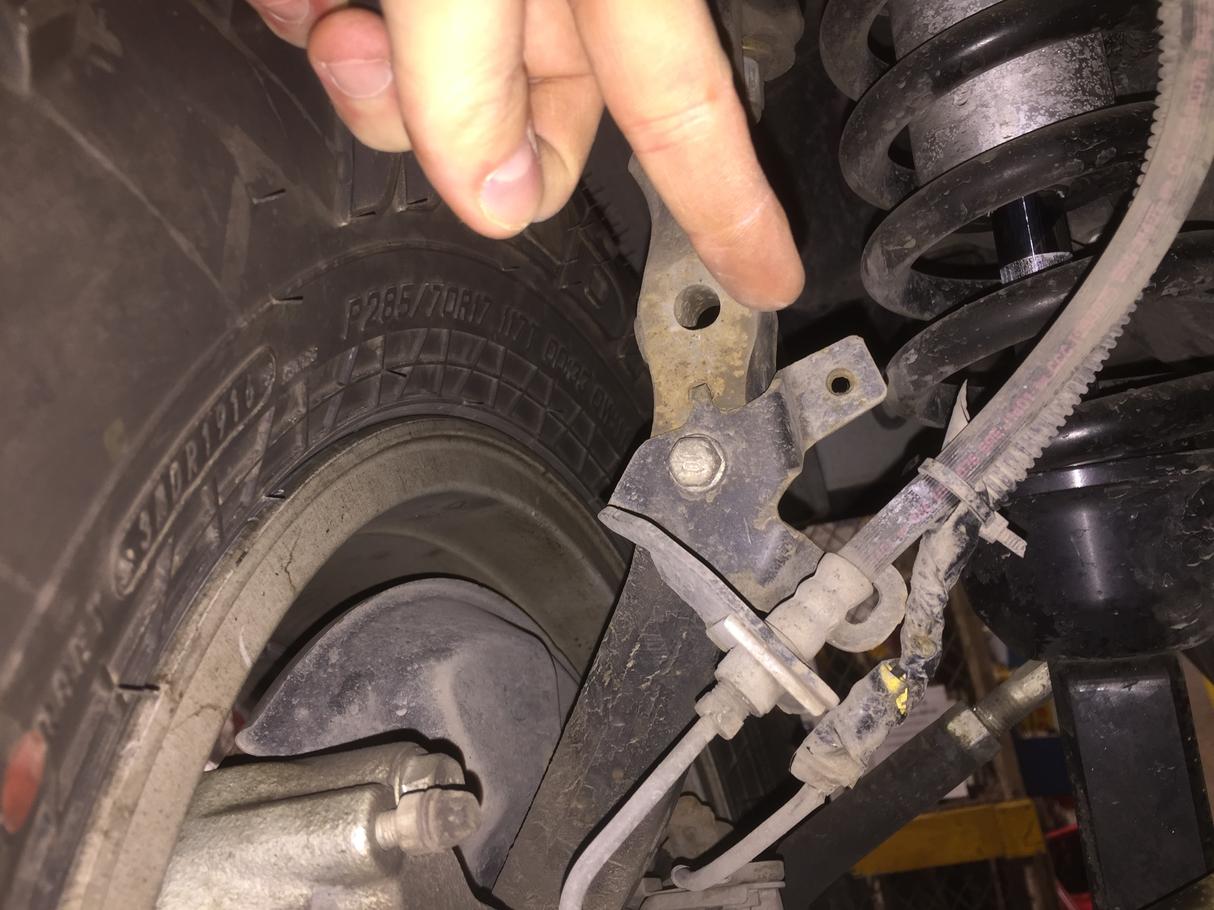

I finally got the time to get under my truck. Looks like the alignment shop really caught the ABS wire good, and then tried fixing it to no avail (since there's no bracket and bolt).

I'm just taking a guess but maybe a wheel speed sensor was damaged OR perhaps the vehicle detects both engine/transmission speed and it's not matching up to new wheel speed. [emoji848] just thinking out loud.
It is not the tiresbeing 285/70s causing the issue. Looks like something was damaged. Make sure all the connections are secure. Lift the vehicle and pull and push on each fron wheel to see if it does not move, bearing issue causing issue with sensor. Lastly a quick code pull could be helpful. That is about my extent except checking fuses. But definitely not the tires. I have them and many others without issue. In fact it isnt even possible to get an error code like tat just because of different tires. Could the y perhaps damaged a tire sensor?
Thanks. I'll research the fix for this. Not sure how he could jack that up doing an alignment... But he must have known he did because when I got back into the truck the clock and compass were off too.
Nothing was jacked up...ABS wire should be fine. It is somewhat normal for this to happen during an alignment. Most shops know.... and many of the advanced machines have a port to resolve it. It simply needs a zero point calibration. This can be done by you or the shop...Just search for the procedure.
I'm not sure why it only happens sometimes. Has something to do with the toe being adjusted and the yaw sensor.
Usually, not always of course, you don't get any dash lights when needing a ZPC. The symptoms for needing a ZPC are having VSC engage under normal driving conditions. Now, when the VSC engages during driving you will get the VSC light but it should not stay on continuously. Here is the link http://www.toyota-4runner.org/5th-g...celeration-sensor-zero-point-calibration.html where that contains that information.
Basically, the Zero Point Calibration is the "starting" point for all your abs, yaw and other sensors. This defines where "Zero" is by starting with the vehicle level front to back and side to side and not moving. With this zero point defined the sensors now have a baseline from which to operate effectively to let VSC do it's job.
With a broken or stretched ABS wire you can get one or a multitude of lights. So yes, it might need the ZPC or it might need a new ABS sensor wire or it could need a new ABS sensor if that one was inadvertently damaged during alignment. You should be able to check codes.
It does set the lights... Seen it happen several times.... It has something to do with the caster sweep/toe adjustment.. I'm sure [MENTION=66389]BlackWorksInc[/MENTION] knows why or when an alignment procedure triggers it... Most likely when the wheel was just not straight before... But I would bet good money that it just needs the calibration and the speed sensors are fine. It's a common thing with many Toyota vehicles that have stability control..

It's not the wheel speed sensor. Turning the cam bolts has no impact on those wire. The only time you mess with the wires is when you remove the UCA/LCA... The lights are the zero point calibration. Ask them if they have the tools to reset it or are familiar with it. The modern Hunter alignment racks walk the tech through the procedure.

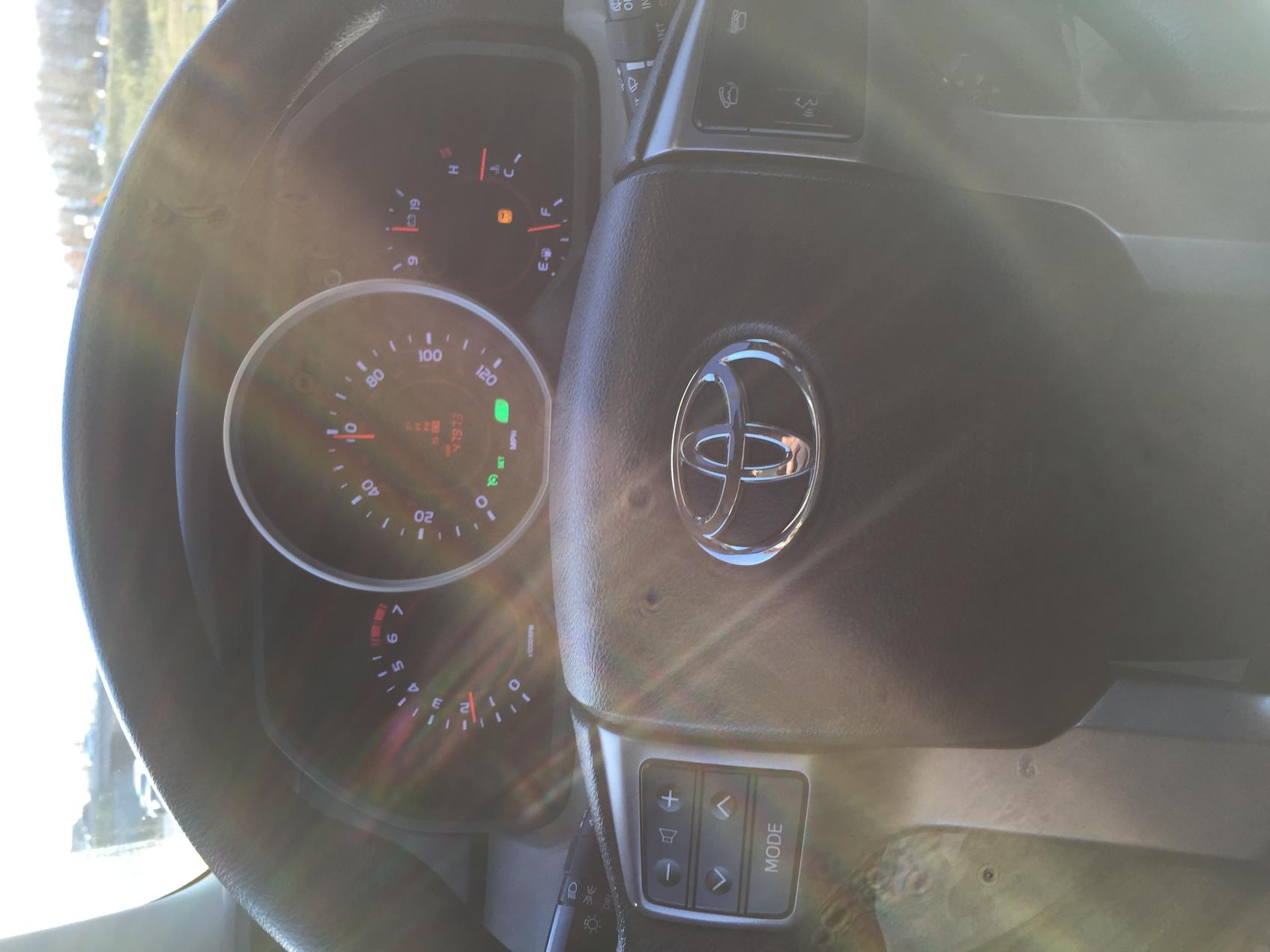

Here's the what my steering wheel looks like while going straight.

Personally besides getting toyota fixing the light issue I would look for a coupon for an alignment mine was around $60 when I put on the front UCA, Rear Springs, and The Front Spacers along with the new toyos in 285 without body mount chop I had Toyota Align it. No issues. But point is have them make sure that everything is correct as well as align your steering wheel.
