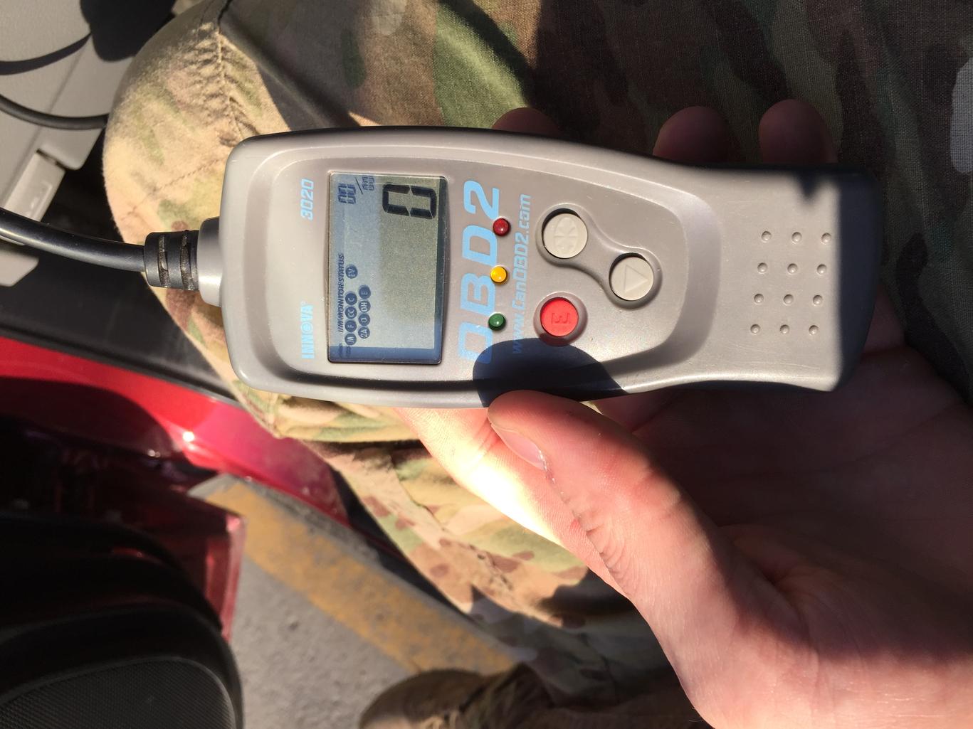

Honestly, I'd like to see what the DTCs are rather than just guess why the light is on...

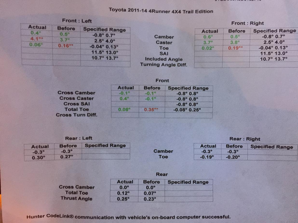

So they realigned it and got the tires to clear the body mount when turned. The manager said to go to Toyota and get them to fix it so the light goes off. He said they'll reimburse me for the cost.
Here's the what my steering wheel looks like while going straight.
Man that's unacceptable !!:toilet3: Most good alignment shops have tool to keep steering wheel straight during procedure or be lucky enough to sit & hold the wheel yourself !!

Sorry for the delay. Life's been out of control busy. I got my T4R checked and zero codes found.

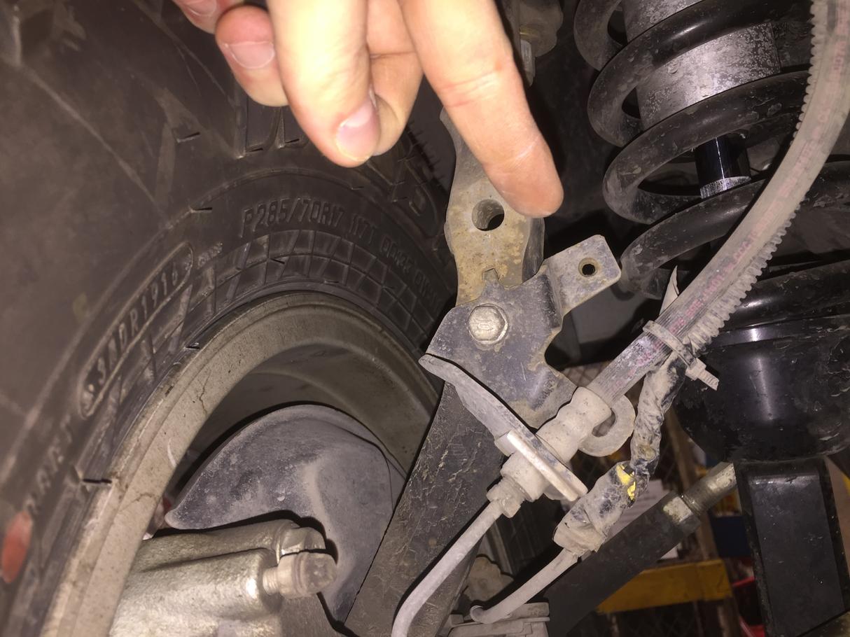

I'm guessing the kid doing the alignment at Sears on my right accidently hit/pulled the wire and tried to "fix" it. Either way, the manager of the shop said he'd pay for the damages to fix it.

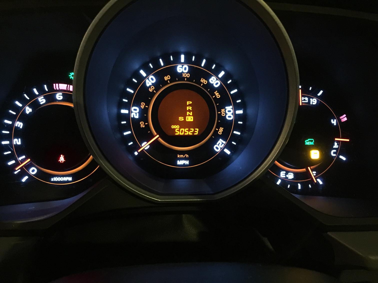

ARGHHHH!!! Took it in for its appointment today to get the steering wheel adjusted. And wouldn't you know- 1.5 hours of them ****ing around with my rig it now pulls right, steering wheel goes a little left (instead of right like before), AND the crawl control light flashes.

Did have sensor wire replaced ? Those things are really very easy to even just stretch , mine was & went thru whole process ! Finally did my on z ! :bigok:
