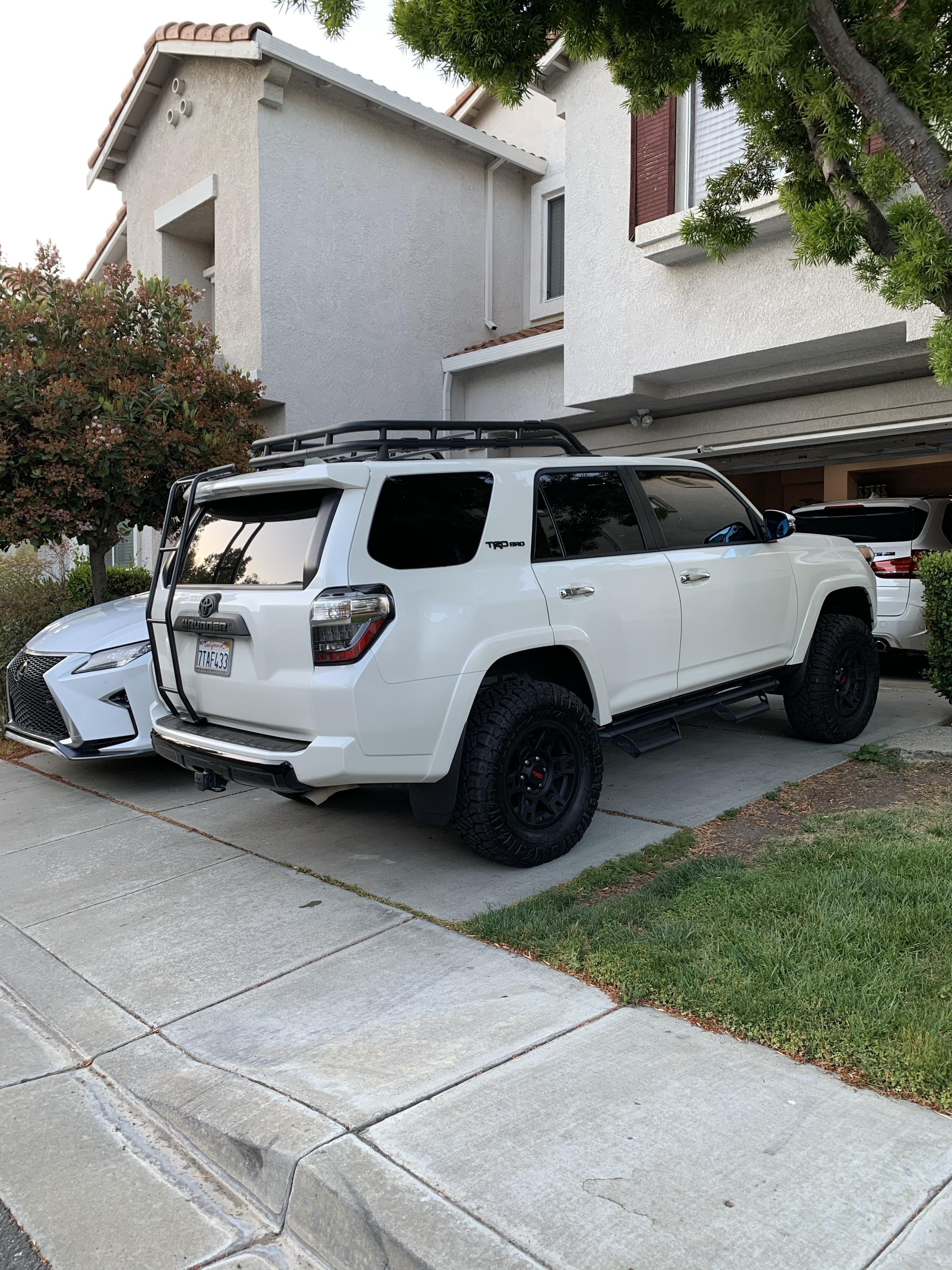

Looks good .. I did the same but with 2/1.5 CF’s, nitto rg’s and black spidertrax 1.25”. I was able to keep all my flaps.

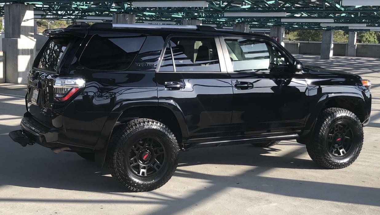

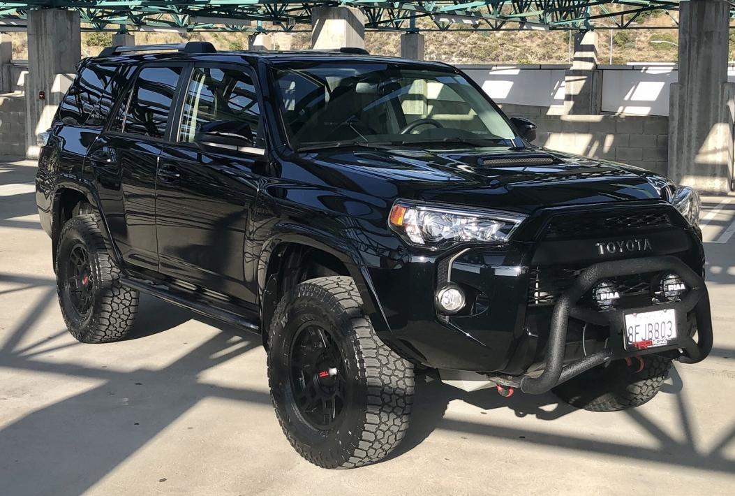

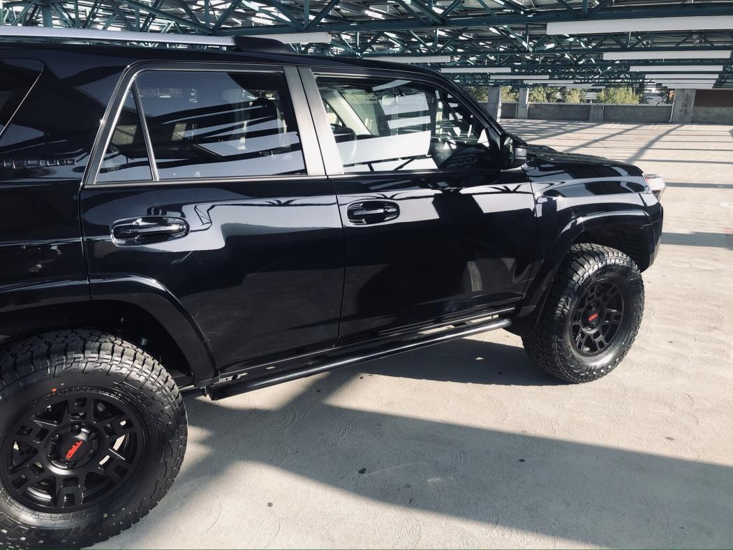

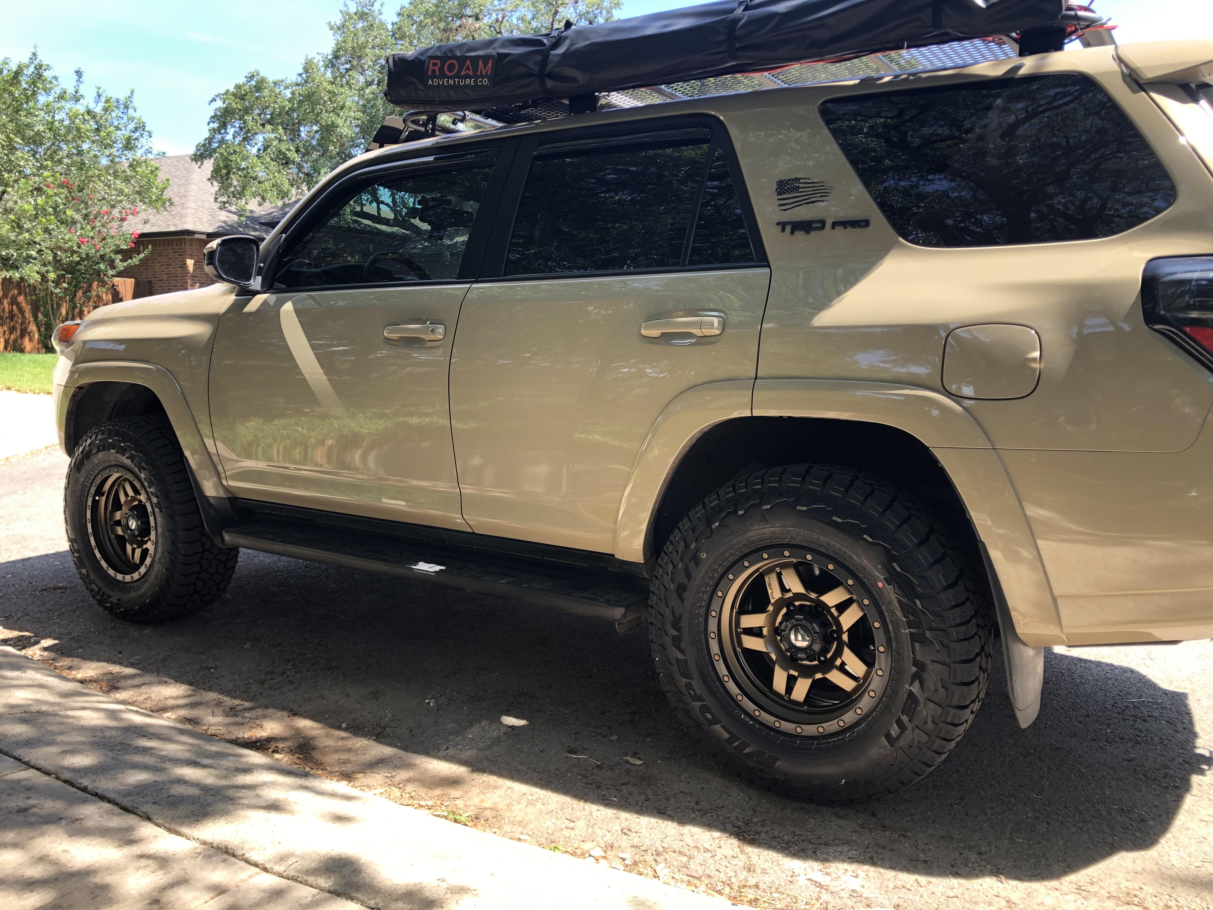

I’ve been running 1.5/1” Cornfed spacers for almost 18 months now. No issues. Just stepped up last week to 285/70-17’s a week ago without any mods or clearance issues at light to moderate articulation. I think the 2/1.5” is probably the perfect place to start, but, I am very happy that I did not have to upgrade. The Pro fender liner/bumper mod combined with the Pros 7” wheel and offset, seems to negate a lot of clearance issues. Never had issues airing down with my 2001 4Runner with 285’s on the OEM 7” wheel. The 285 fills out the wheel well perfectly. IMO
