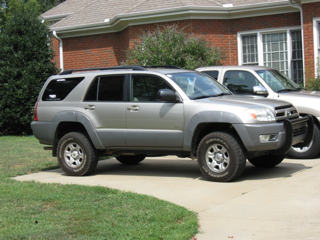

I use 265/75/16 BFg I have OME 3" lift etc.
I keep with this size because I DO alot of Off roading and the width is not why I get stuck , Plus the Atrac likes this size tire better/ also the whole front end likes a smaller rotating Mass, Etc . Ihave several friends That use the 255/80/16 Size in BFG Mud terrains with good results.Just depends on what you really want and use your vehicle for .
PICT0006.jpg~original
That is one sweet looking rig!
