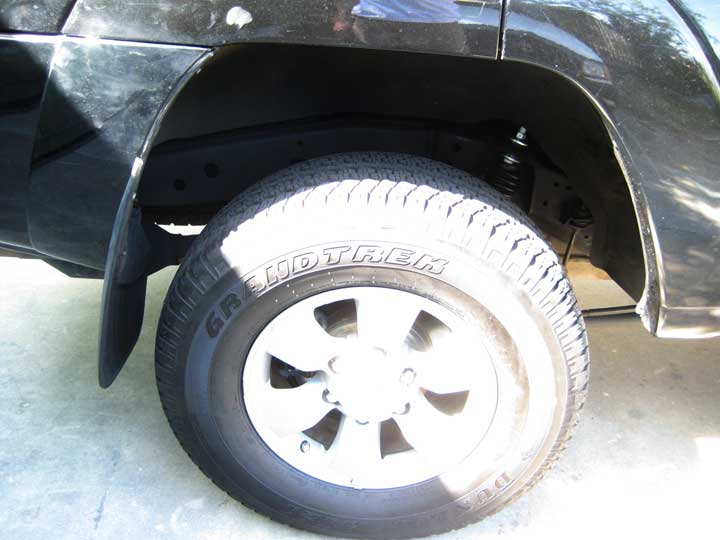

Oh boy. Well I'm gonna remove the mudflaps and put on a Roger Brown Bodylift (1.25") and go back there and do a testfit again. I don't want to take too much off the outer lower fender- I'm fine with loosing as much of the interior as I have to. I love the wide tire / wide stance look as well as being able to clear the rocks and worn paths I ride when I go shooting or down to Mexico. Thanks for your help.
back tire shot of revtek 2" rear

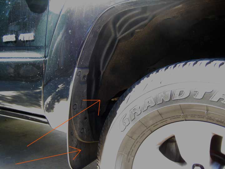

Here is the area I was worried about dealing with with the 32.5" tires (285/65/18 Nitto T/Gs). Other than removing the mudflaps (lower arrow) I won't have to do anything to that part of the liner right? (Upper arrow)
Wolf said:
Sorry to hijack your thread but you sold them anyway and this is related :)
I didn't trim that inner fender when I had my 33", so you're fine. But mudflaps are to go.

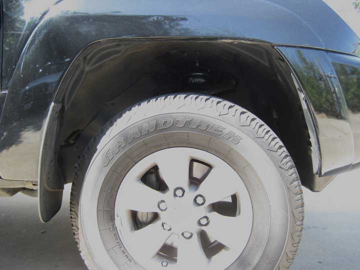

AlexJet said:
This would have to go:
rev-front-rt4.jpg~original
Cool. Mudflaps are off. I'm putting on my RB lift when it arrives and I'll go back and get em mounted then I can just trim that area up front only as much as is needed. This forum is great thanks to people like you- who help people like me from avoiding mistakes in modifications!! :)
