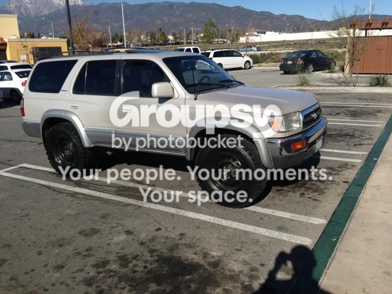

Check my build thread, I just threw some on my '98, no lift. If I stuff the rears they rub the fender lip but lock to lock in the front I'm not having any issues with my 1.25" spacers.
