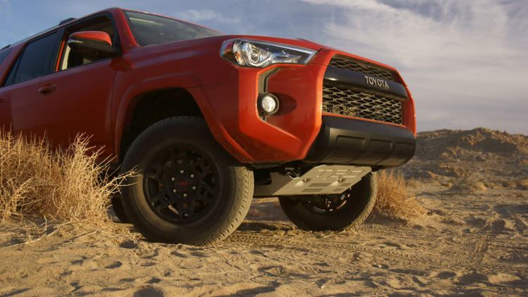

Hey everyone. I'm looking at lifting my 15 TRDP. I want to do 285/75r17 (most likely BFG M/T). The BFG website recommends minimum 7.5". So is it possible to put 285/75 on the 7" wide TRDP wheel???
Thanks.

Eh, you might be able to fit it. But I don't know if I would want to risk it to be honest with you.
Half an inch may not sound like much, but I am running 285/70R17's on my 4th gen and they also recommend 7.5" min width (my factory rims are 7.5"). They "suck-in" at the rim's edge pretty good for a 11" wide tire. The manufacturer is recommending that minimum width because the bead is probably not seating properly on skinnier rims and cause the bead to fold and pop off the rim if you're aired down on obstacles. So it might work fine and it might not.

The guys on expedition overland specifically swapped out the trail rims (7.5 wide) for the TRD rims this season and put on 285 General Grabbers (which recommends a 7.5" rim). Seemed to have worked for them.

Each tire mfg gives a recommended min and max rim width for each tire they sell. Many shops will only mount the tire if your rim is within that specified range. So look up the specs on the tire you want and go with that. Is it different for each specific tire, but 7.5 is probably the min for a 285/75 17.
There are plenty of people running 285+ on the stock TRDP and SR5 wheels. There's even someone running the wider 12.5" General Red Letters. The question is how far you are willing to push the manufacturers recommended wheel widths. The most adverse effect you will encounter is poor/uneven tire wear.
I'm currently running a 34x10.5 on my TRDP which is taller than a 285 but close to a factory tire in tread width.
