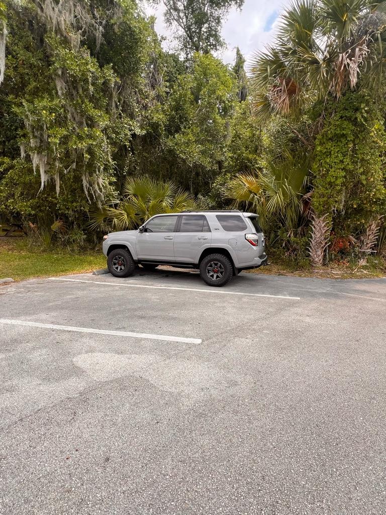

This is pro fox with westcott designs pro lift and 285/70/17
