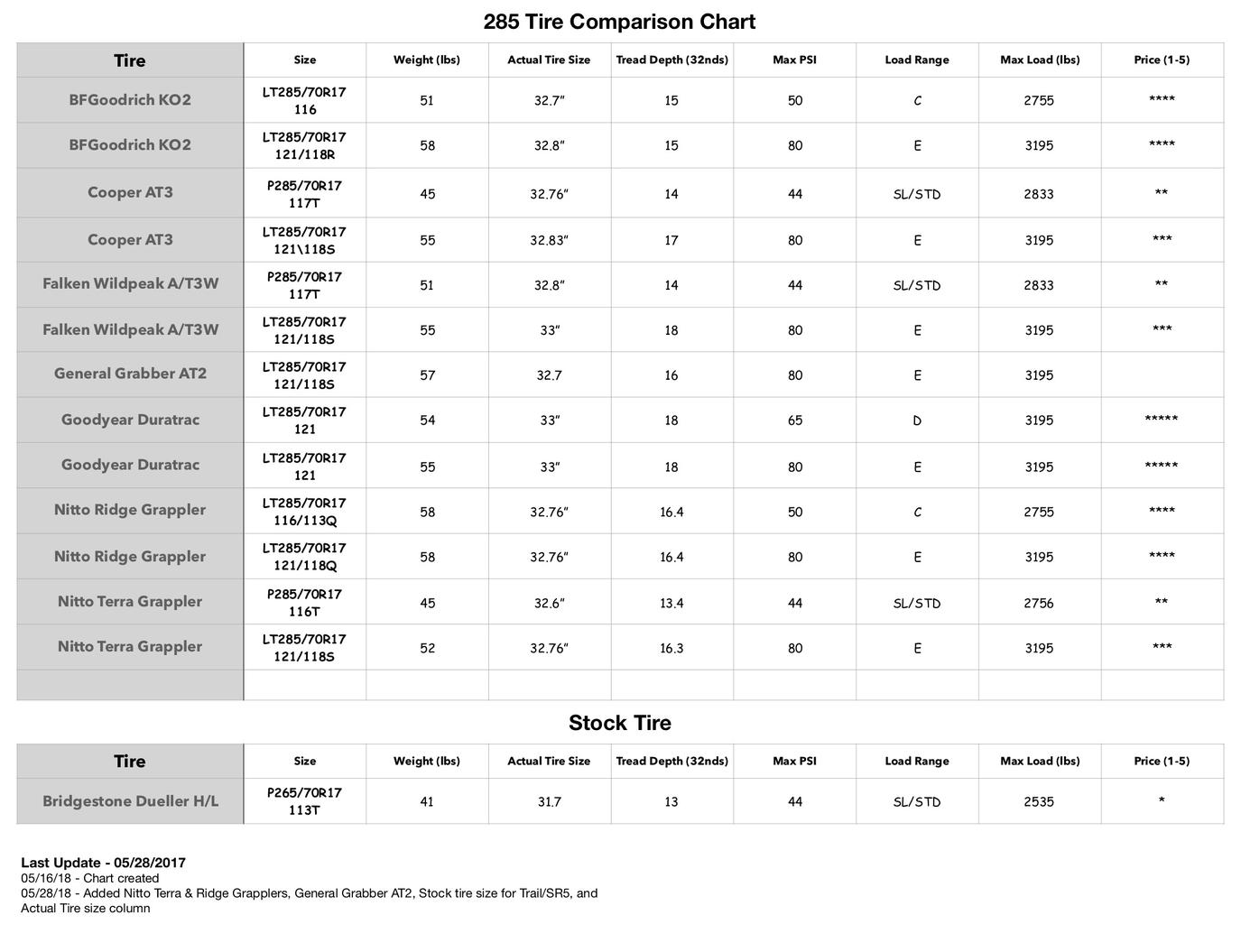

285 Tire Size Comparison Chart
neatoneto
285 Tire Comparison.jpg​
I've been researching the 285 tire size options for so long I figured I'd put together a comparison chart that is easy to reference and has the important information I look for.
I would LOVE feedback from you guys on this. What information do you feel is missing but is important? What tires did I miss that you would recommend?
Thanks
Edits:
05/28/18 - Added changes to chart
actual measured size while installed.
Agreed. Cooper STT Pros 285/70/17s are 33.03" while the same size in BFG KO2s are 32.87"
Can you add Ridge Grapplers to this? :)
Thanks for your input! How could I forget the Nitto’s? I’ve thought about adding actual tire size since they all range from 32.7-33.1 but that wasn’t important to me.. perhaps it may be a good idea though depending on what it is you’re looking for!
Every half inch counts:violin:
I’d add 255/80/17 options as well since they are also 33” there’s not a whole lot of options in that size though, Nitto Ridge Grappler, Cooper ST Maxx, and BFG KM2.
I myself am a huge fan of the 255/80 size. I may end up add that, 255/75 and 285/75 sizes eventually.
Added some of the suggested content to the chart. Please please please.. I'd take some more feedback. Is this helpful or not? What else is missing?
Is the info on KO2 vs Ridge Grapplers correct? I have 285 RGs and they are noticeably bigger than a comparable KO2 (Both tires were brand new)
I think this would be about like asking OTD pricing - you need to include wheel width, tire pressure, weight of the truck, how was it measured, etc - (eye balling with a tape measure on the ground to the top of the tire would give me 5 different results if I asked 5 people....)
Perhaps add the stock tire information for TRD Pro’s as well.
Noted
Very true. Not sure what exactly causes it but I believe these are all factors.
I ordered KO2's in load C.
Your chart has them as
LT285/70 R17/116
They are LT285/70 R17/116/113Q (according to the MFG site).
And, it's listed as 32.8" - I haven't gotten my tires to measure though.
LT285/70 R17/116
Noted. Please update us on your measurements! I am actually going to be order the same exact tires soon as well.
