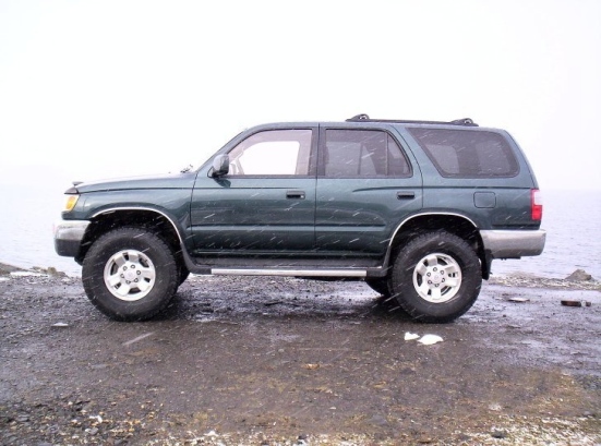

What do you think?
265-70R16
Can't tell from the picture.
Measure from the wheel hub center to the wheel well lip. The average 4wd measurement is ~20".
