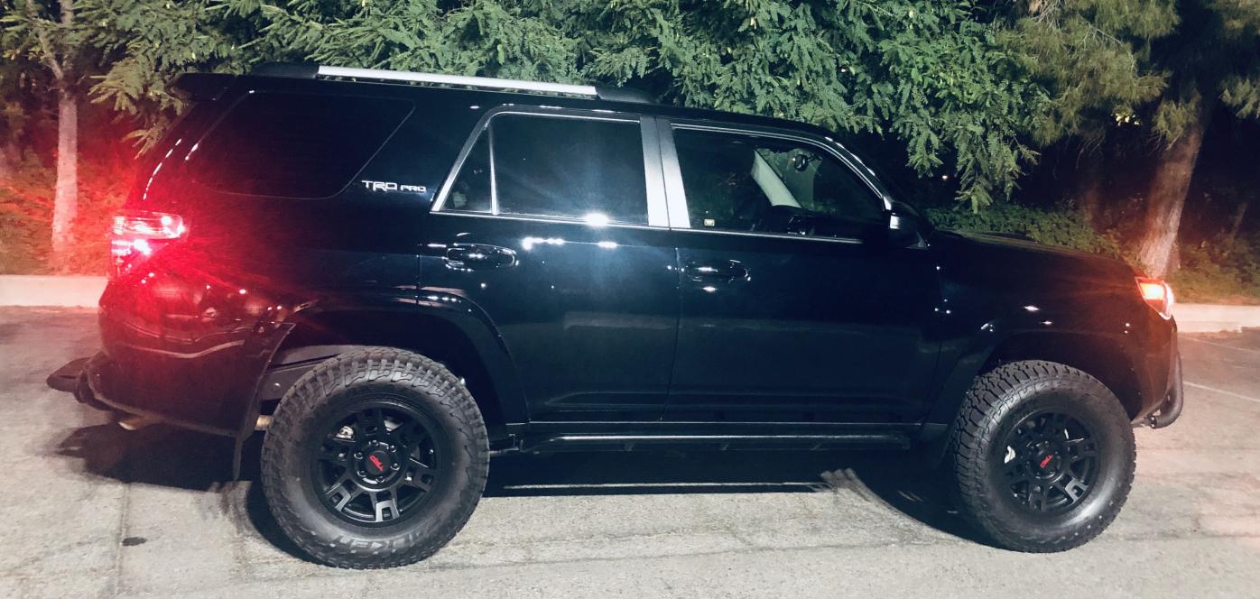

Falken Wildpeaks SL AT3W 285-70-17’s on OEM Pro wheels. 51#’s each. Smooth, fairly quiet ride. 2.5” up front, 1” rear. No mods or rubbing. The offset and width of the Pro wheel along with a 285/70-17 allows for the best clearance with the least amount of mods. I get 15 +/- 1/2 mpg street. Waiting for a road trip to check hwy mileage. It’s a 2 1/2 ton brick. Don’t expect much. At $3 per gallon on a 1000 mile road trip, the difference between 16mpg and 19mpg is $30. Even if you are doing as much as 3k a month, $90 extra is nothing.
