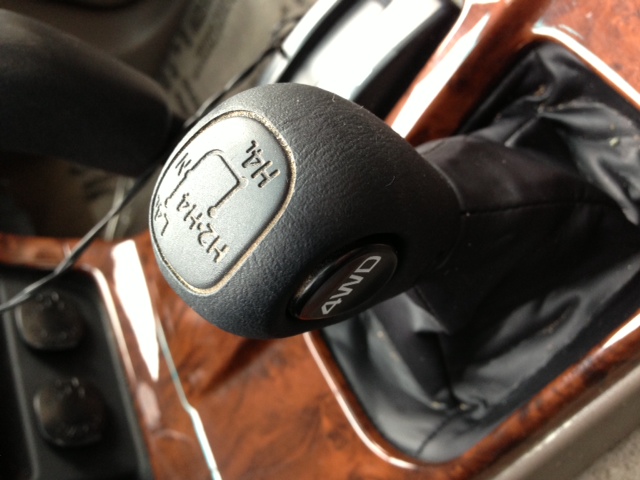

2hi-4hi... 4hi-l... N... L4
The year of your 4runner would help a little because they all vary.
But to me it seems like you have a 2000 with the AWD feature. I could be wrong though.
2-Hi- normal everyday 2WD
4-Hi- AWD feature. Basically lets you drive in 4WD on the road safely.
4-Hi-L- 4WD Locked. This is like any traditional 4x4 system. Use this when offroading and never use this on road.
4-Lo- This is like traditional 4x4 system as well just in the low gear. Use this for rock crawling or anything you need a low gear for basically. Don't drive this on road either.
thanks! its a 2000 limited

You have what's called a J-shift transfer case. The button on the side allows you to put it into an AWD state keeping the center diff unlocked. The second L in the combination of letters stands for Locked (aka locking the center diff).
THIS will help you out..
x2 on what he said.
