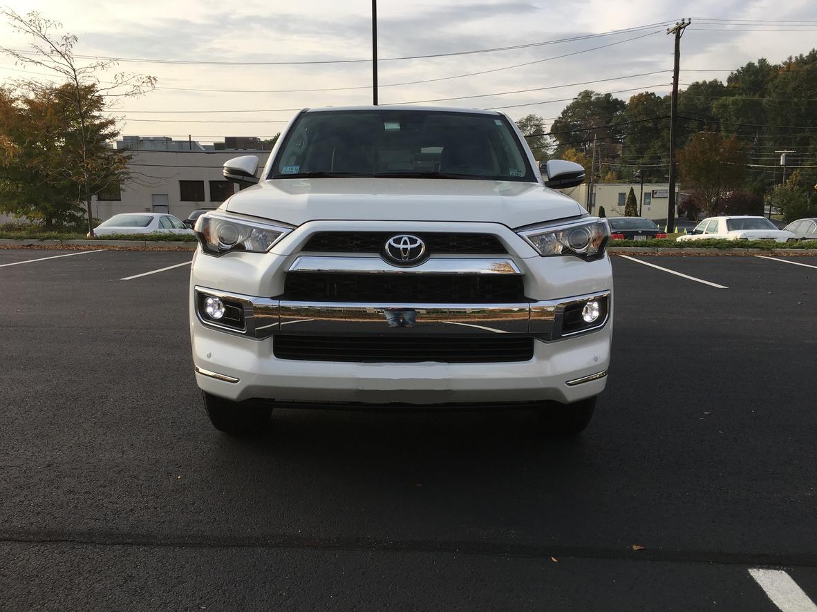

Got them installed a month ago.
Toyota kit, Looks good
