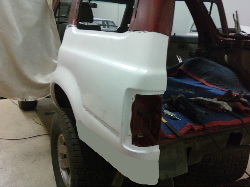

Corey, also consider a deletion of the inset portion normally covered by the rear bumper wings (where those 2 10mm bolts attach the fender wing bracket.
ie: The lower rear 5-6"(?) high by 18"(?) long section. It would really clean up the look for guys running tube bumpers to have a cleaner transition and area less prone to accumulating debris. Heck, for that matter a dogleg panel deletion also where the rear fender meets the rear door at the body seam.
Just thinking aloud here. (3 minute photo-correction hack-job example to see it.)

That is the nice thing with FRP ... you can modify it very easly . We could do that for a customer , but the moulds are already made for the "stock panel" . our Hi clearance panel will most likely have that piece deleted , as it would be more popular with the custom croud .
