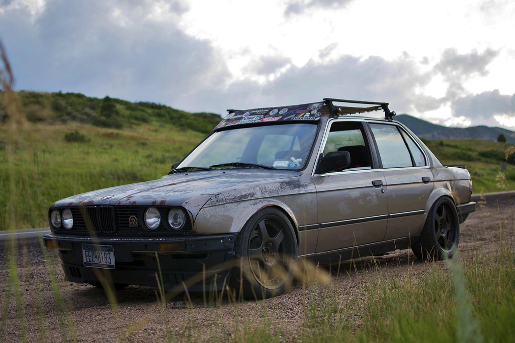

My name is Brandon and come from the BMW e30 world. I built a ground up ratrod made to do SCCA, canyons, and light track.
Click to check out my e30 build!
