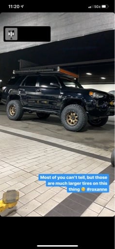

Honestly I think those are the perfect size tires for our 4Runners. It's just a shame those tires are like $340 a piece!!! That's the only thing holding me back from getting them. I love that they are D rated and only weigh 54 lbs too.
Agreed. They definitely arnt cheap, especially when you buy 6 [emoji2359]. But I definitely feel like they’re well suited for Toyota’s.
Let’s see those new tires on.

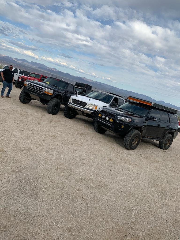

I’ve been so busy with the 1000 these last few weeks I literally put them on and parked the truck and it’s been sitting. So I only have one picture [emoji23] but here ya go. Picture of the race truck too because it’s way cooler than my mini van.

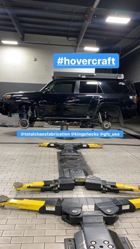

This build is awesome. I’d like to see more pictures of your current front and rear suspension setup as well as rear suspension setup before the 3.0s
I don’t really have a whole lot besides what’s posted on here. There’s a little bit of stuff on my instagram. Prior to the 3.0 I just had a standard king 2.5 with some valving changes everything else is the same. Next time I have the wheels off I’ll take some more detailed pictures

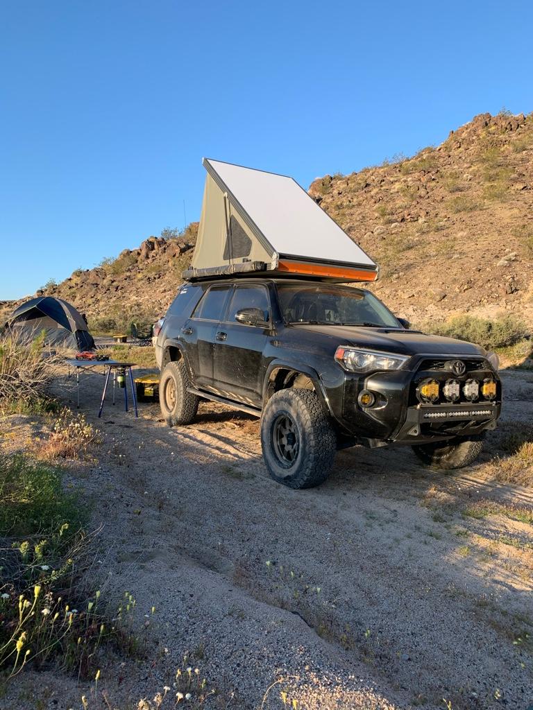

Been getting some use out of this thing. No issues and I don’t think I’ve ever owned a more well balanced vehicle for different terrains. Pulled the trigger on some gears finally. Should be here in a few weeks.

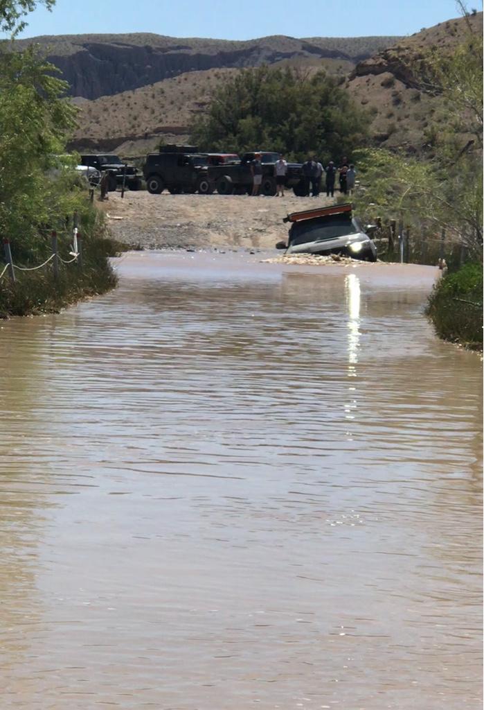

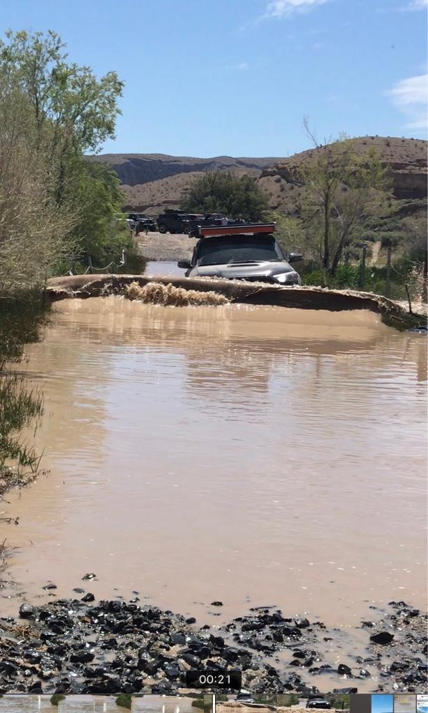

Did the Mojave trail last weekend. Water crossing was semi deep. No issues all weekend it was a great time.
