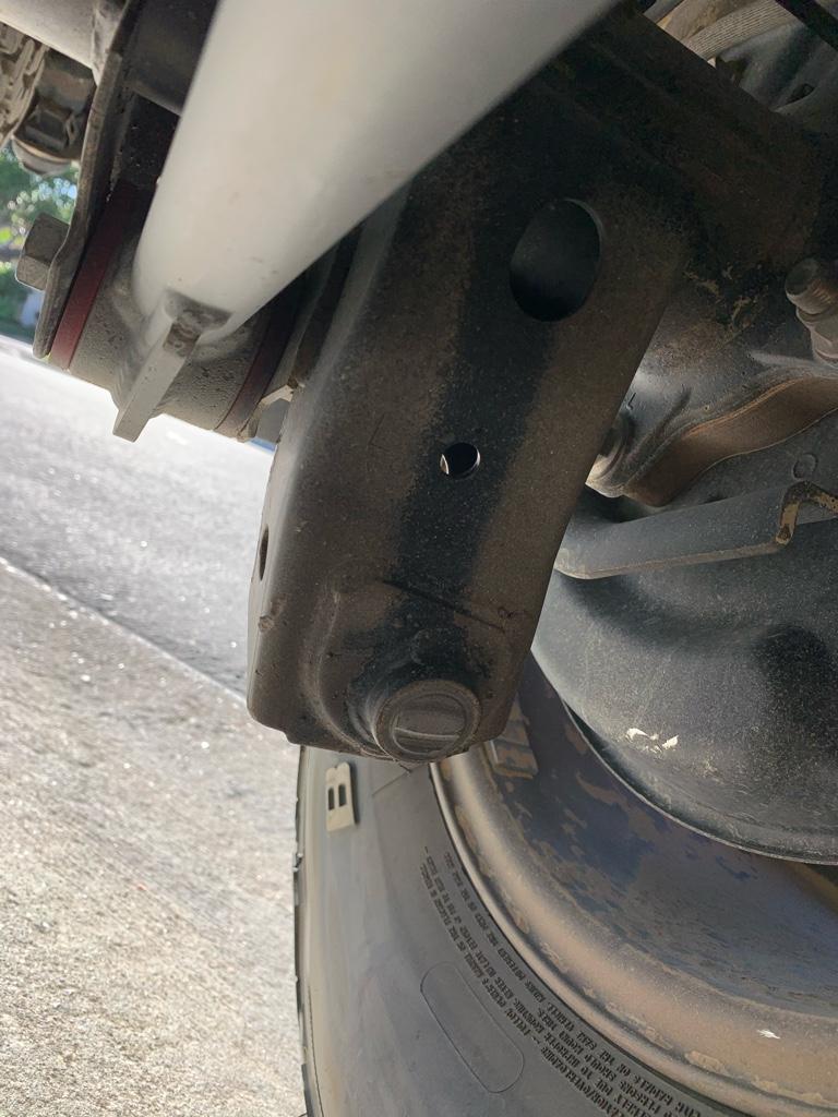

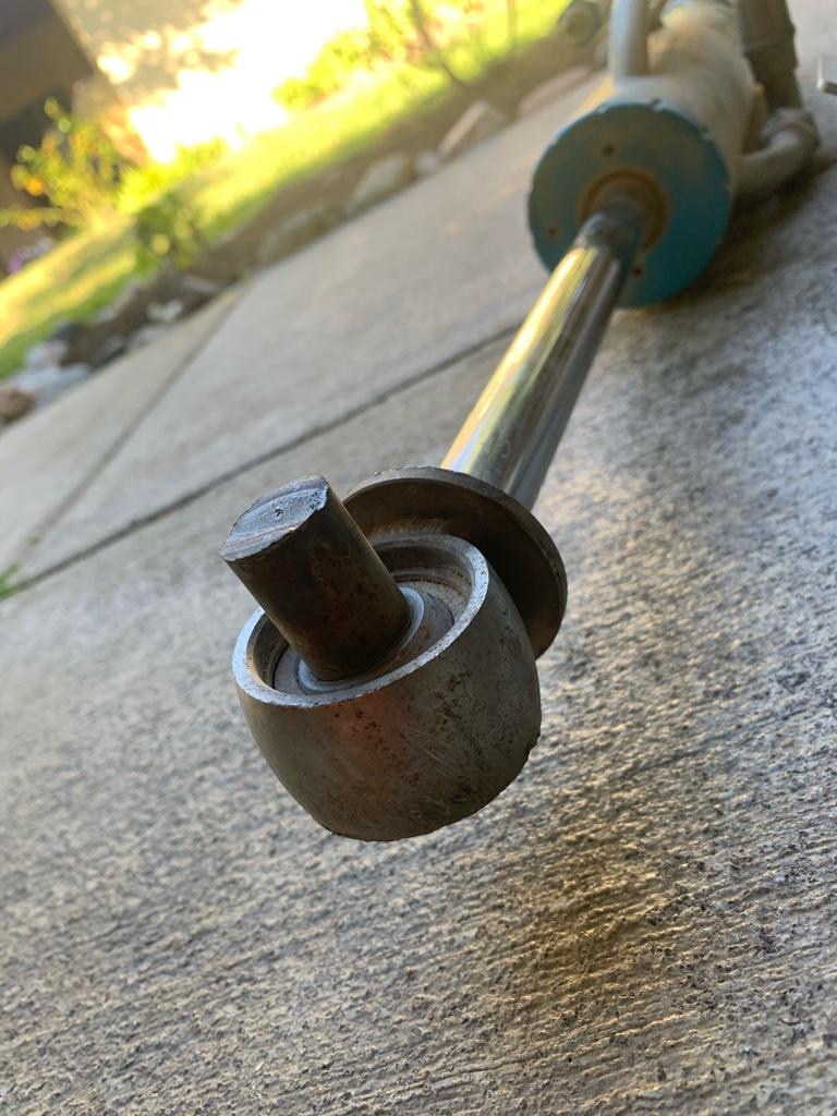

Busted a shock mount in Lucerne this weekend. I’ll post some pictures of how I plan on upgrading it later in the week. I’m thinking thru bolting and possibly double shearing it. Along with moving my bumps down.

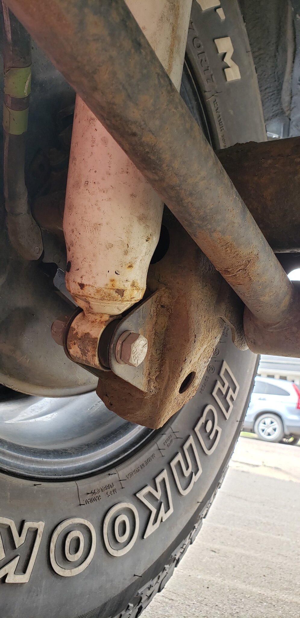

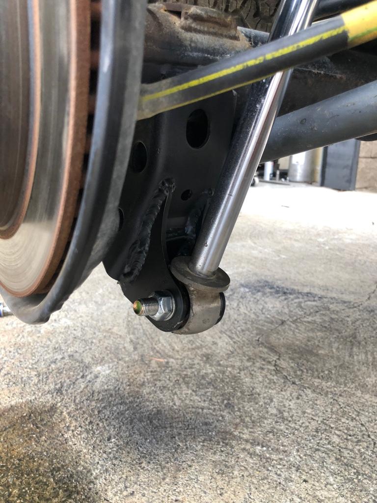

I did the same thing in Moab. The drill through and mount with a bolt option does work and did work for me for awhile, but then I switched over to using a TeraFlex lower shock bar pin eliminator kit for an XJ. I was able to move the lowest part of the shock up about 1.5" and haven't had any issues. I welded it on the flat part above where the original lower shock mounted- lots of room. The two bolt holes on the mount area serve as rossette weld points, and then perimeter weld.
Just another option that has served me well.

doesnt that mean you lose 1.5" of bump travel?
