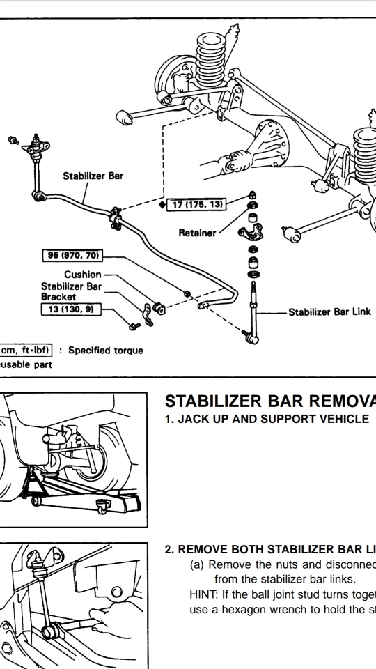

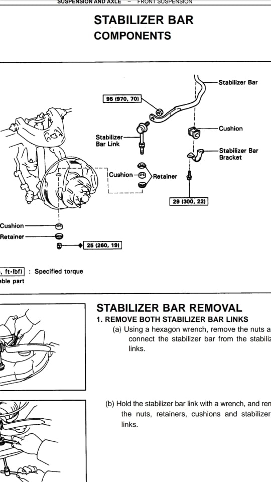

I've been searching for info on the various bolt/nut torque specs for specifically the front and rear sway bars. My Haynes book doesn't have them, searching the internet just returns all kinds of answers. Anyone know what they are or should I just do the old fashioned... tight then 1/4 turn?
Here you go, use the numbers all the way to the Left as NM specs.
Thank you! For the spec diagram. My book didn’t have the specs. I would have replied sooner but I was out camping with my other Toyota!
