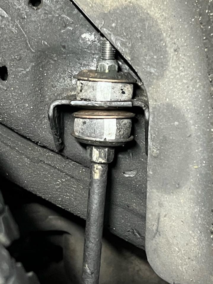

Recently I upgraded my suspension (mild Dobinsons lift (3/4" Front - 1/2" rear) and new stock size KO3's. So I decided to replace the front and rear sway bar bushings and the rear link bushings.
Do these look like they need to be compacted more? I'm trying to go off of what the originals looked like, and push them out but not past the edge of the cup of the retainer. TSM says 11 ft lbs but I did these on the ground with tires on and didn't have a 12mm torque adaptor extension.
