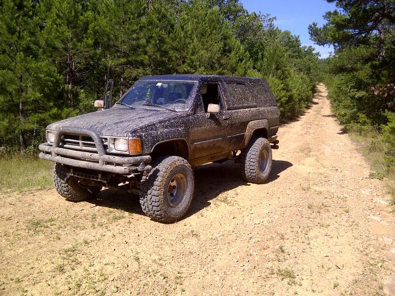

I did a 3" BL on mine. Had to lenghten the brake lines by uncoiling them (Front). Added a longer Clutch line, Like buck said. Had to add 3" to both my shift levers. Oh and had to pull out my steering rod 1.5 ", Otherwise all other stuff to do it was included in my kit. ie: Bumper extensions (front only), Radiator drop bracket, and fuel filler neck extension. Note: A day after the lift, My intake hose broke. So watch out for this. The A/C line will strectch tought. I'm still waiting to see if it will break, so far its good. and lastly for your info I am running 33s and no rubbing with this lift. Hope this helps a little.
