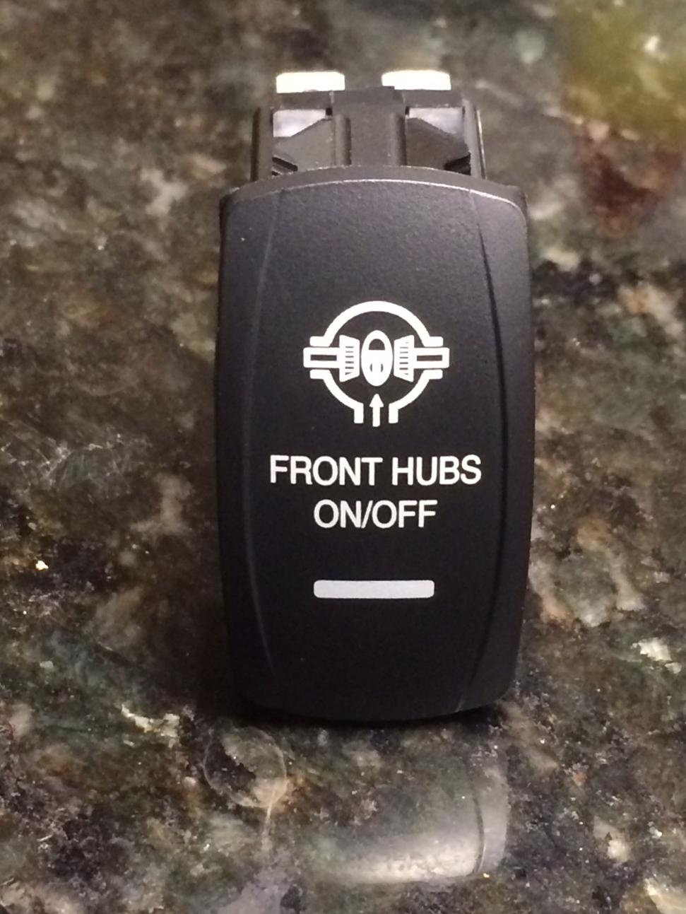

After reading up on the "2WD Lo" mod I decided to do it. It seems pretty straight forward and will come in handy for backing trailers up my steep driveway. I went to OTRATTW and had them make a custom laser etched switch to mount in one of the knockouts to the left of the steering wheel. They had several stock switches that were for front lockers, but since I don't have a front locker I thought "Front Hubs" was a more accurate description. The "Front Hubs On/Off" will be illuminated with the rest of the interior lighting and the logo and indicator bar will illuminate when the switch (and hubs) is on. It may be a couple of weeks before I have time to wire it up, but I think it's gonna be awesome.

Let us know how this goes when you get it finished. I've been considering this too.
Good luck.
