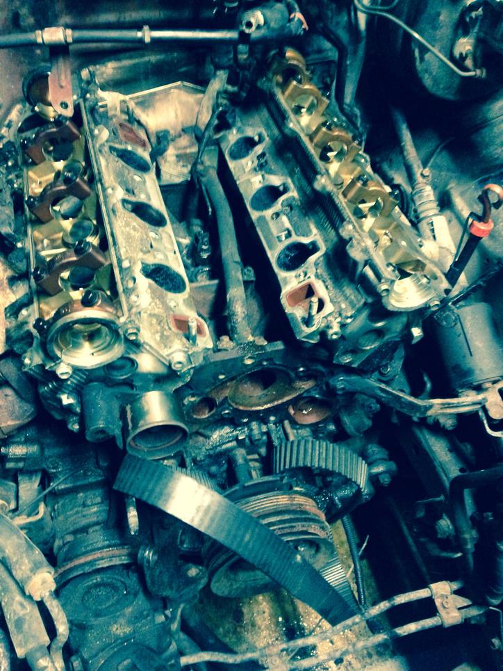

Well my buddy finally compiled all the parts to do the head gasket fix on my old '95. When I did the compression test numbers were 1-140, 2-95, 3-135, 4-140, 5-135, 6-140. So I really expected to find my problem on #2. Pulled the heads off tonight and to my suprise number 2 looked flawless. However #6 definitely has a crack in the gasket. Also #5 looks suspicious. And both bad spots are all the way to the back right next to the damned x-over pipe. I'll try to get a good pic to see what you guys think. I knew 5&6 were very prone to blowing so I'm sure that's where I was getting my problems from. Just weird #2 was down on comp. but not the cylinders that appear to be blown. Cylinder walls look great. Not a lot of carbon built up in the heads so that's good. The gaskets were Fel-pro and one of the cam pulleys was on backwards so looks like someone has been in here before. I can see x-hatching in the walls and there's no ridge at all on the top so I'm thinking maybe this motor had a total rebuild at some point. Heads are headed to the machine shop tomorrow to get checked out. If #2 check out ok I don't know what's next. I guess well just see what the head guy says.
Here's a pic before I took the heads off. Didn't have the right socket last night.

We really didn't take any pics and it's ready to start reassembly as soon as the heads check out. I'll let you know we get messing with it again. I'm right in Cobbs Creek so not to far from you.
Well I tried to snap some pics of the head gasket but to get close enough it just gets blurry. But as we cleaned the surface head there was a lot of pitting between the cylinder and water jacket where it was blown. Heads are off to get machined and tested. We also noticed that a few of the injectors had cracks in the pintle caps so looks like we'll be rebuildng them as well. He's not looking to spend another $300 on new injectors. Hopefully we'll have the heads back and all the other misc. parts by next weekend to start getting it back together.
