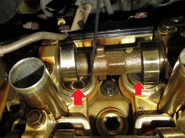

I just rebuilt the top end on my 99 and the valve clearances were adjusted by shimming. If it's ticking extremely loud then adjust the valves. If you can't hear it with the windows up then forget it and just drive the truck.
Sent from my SM-G900W8 using Tapatalk
I always thought mine just had shims for adjusting valve clearance.

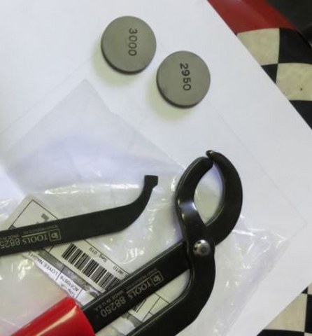

Yep, shims. At 140k miles on my 5VZ I only adjusted 1 valve (it was out .002"), - I could've probably just left it alone.
Per Alldata
Intake 0.13-0.23 mm
Exhaust 0.27-0.37 mm

So I'm guessing you had a shop assemble the heads? Ask for a copy of what they shimmed the valves to. like everyone else is saying, there aren't lifters on the 3.4, the bucket holds the shim, sits on top of the valve, the cam sits right on top of the bucket.
If the shop didn't keep records of the valve lashing, then pull the covers and check the tolerance's yourself. If they're a in spec, is that what is causing the noise? Could be a keeper wasn't set all the way and has backed out.
Bucket & Shim design on the vehicle not hydraulic lash adjusters. It's possible they were not shimmed correctly; I'm with [MENTION=143110]Manic[/MENTION] ask the shop if they can send you a copy of the shims/clearances recorded when rebuilding.
Worst case scenario if it bothers you that much and you think it's the valve lash you can always pop the covers off and measure them.
I had a machine shop do the heads. I got them back ready to go pretty much. All I had to do it set the cams up and put them on. I didn't even think about this and checking there work. I should have because the sub gear was off and I took them back to have that issue fixed. So with that being said I'm either going to monitor it or take the valve cover off and see what one is off I guess because I did all the work myself.
