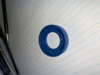

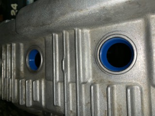

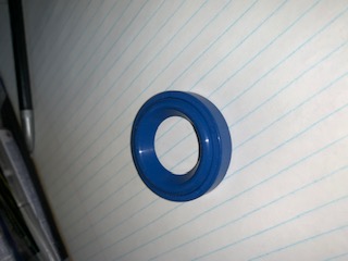

Hi. Just joined, this is a great thread...very helpful...and it is still alive!
I'm wondering how do the FelPro tube seals go in?
They look completely different than the stock seals and there's no tech sheet in the gasket set that I got. Been a while since I wrenched on cars, but FelPro used to be great...and typically if their part deviated from stock they'd have a sheet in there explaining it...not in mine. I didn't realize oem parts were so easy to get now, so I had already ordered these before I started.
So question is anyone know which way they go in?
Seems the flat side would match with the inside of the valve cover, but trying to pound it in with the open side, I can't seem to seat them...
After reading this thread I'm going to use the freeze trick for the other cover but for now I'm a bit confused...
I'm attaching a couple photos of what I have. Any suggestions appreciated.
Thanks - Rob
PS: props to Timmy The Toolman his videos are great! Made this and my timing belt replacement a walk in the park!

Good and very valid questions. I ran into the same situation and problems when I did mine last year. Sorry, but I have forgotten some of the details of what I did, so my reply might not be very helpful.
I was scratching my head too, and installed mine with the opening of the seals downward. I used the freezer trick. I also lightly lubed the outside of the seals. Getting them in was very tricky. If I recall, I used a small wood block and a large wood dowel to tap them in, and kept tapping until I got them as flush as I could. They have to be tapped very carefully, or the outer edge will get deformed.
Because of those questions and difficulties, when I had other problems and had to do part of the job again (I cracked a valve cover during installation), when I got new spark plug seals again, I think I got OEM ones from the local stealership. Either that, or a different brand than Felpro, from Rockauto.
Outrider,
Thanks for the reply.
I went ahead and left them open side down too on driver side...
I'm looking at oem on pass side and peeled back the seal guts...the spring is up and they have a boot-like part on the bottom...if I install FelPro that way then it is like driving the seal in "normal", but leaves opening under inside of valve cover...what a pita...I already put the drive side back together, but seriously thinking about just getting oem and do it again while I still have all the upper end in pieces.
Can't figure out if these are supposed to keep crap out or oil in...seems oil in, and the plug boot keeps crap out...
Un freakn believable, I've not run into this b.s. on any other engine I've worked on using FelPro... :ybrick:
