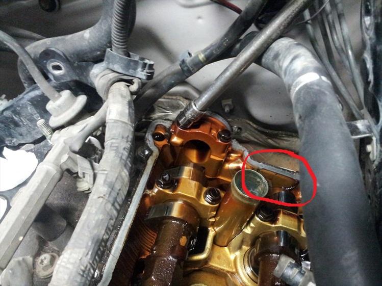

did this yesterday. no coolant came out; great. i was surprised on how clean the inside was. very clean just like the photo. was a pita but got it done.
just curious, but where exactly are the half moons located? It's hard to see from the pics.
