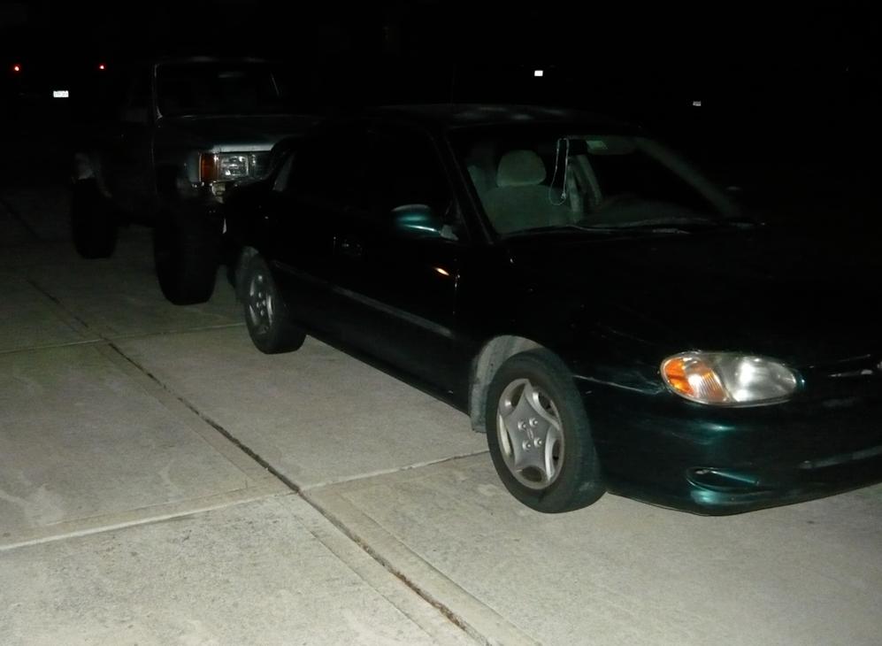

That's funny you mention a geo...I'm looking for something with mpg like that for when the gas goes crazy high this summer

I'm running the 3.Slow in an '89 5-Speed with stock gearing and 31x10.5X15 and I am only getting 14mpg. I too am looking at a 3.4 swap (or maybe something way out in left field with an LS.....not a 7 but an LS none the less) but........I know I wont be saving any money in the process. I sure wont ever make up the difference in fuel mileage. I will be doing it cause I love the 1Gen look and I know the 3.Slow, like any engine, will fail eventually.
That being said, I won't do anything with the 3.Slow until it does fail. If I can get 2 years out of it, it has 210k on it now, then I will have the money stashed away to do what I want. I drive 50 miles one way to work. That sucks at 14 miles to the gallon. But that is why I have a 2001 Kia Sephia that I picked up for 600 bucks. I did a little work to get the power steering and A/C going and now I get 38 mpg. That is how I would fight the price of "liquid gold" if I were in your shoes. Start making those drives home in a little car and save the wear and tear on the 3.0. Obliviously there will be times where weather would be rough in a little car so in that case you have the t4r.
Run that 3.Slow in the ground. When it fails, evaluate whether it is worth it to fix or swap. But swap for the fun and because it is time. Don't do it early to try and save some mpg. Make sure your insurance has Roadside towing and drive the heck out out of it.
Just my .02.
