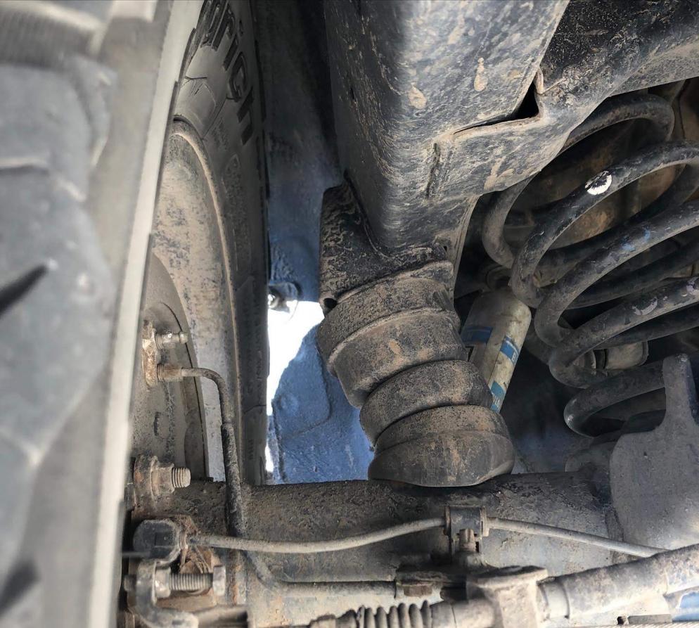

here are some pics of the 5.25's about as compressed as I could get mine. really stuff the 285's
