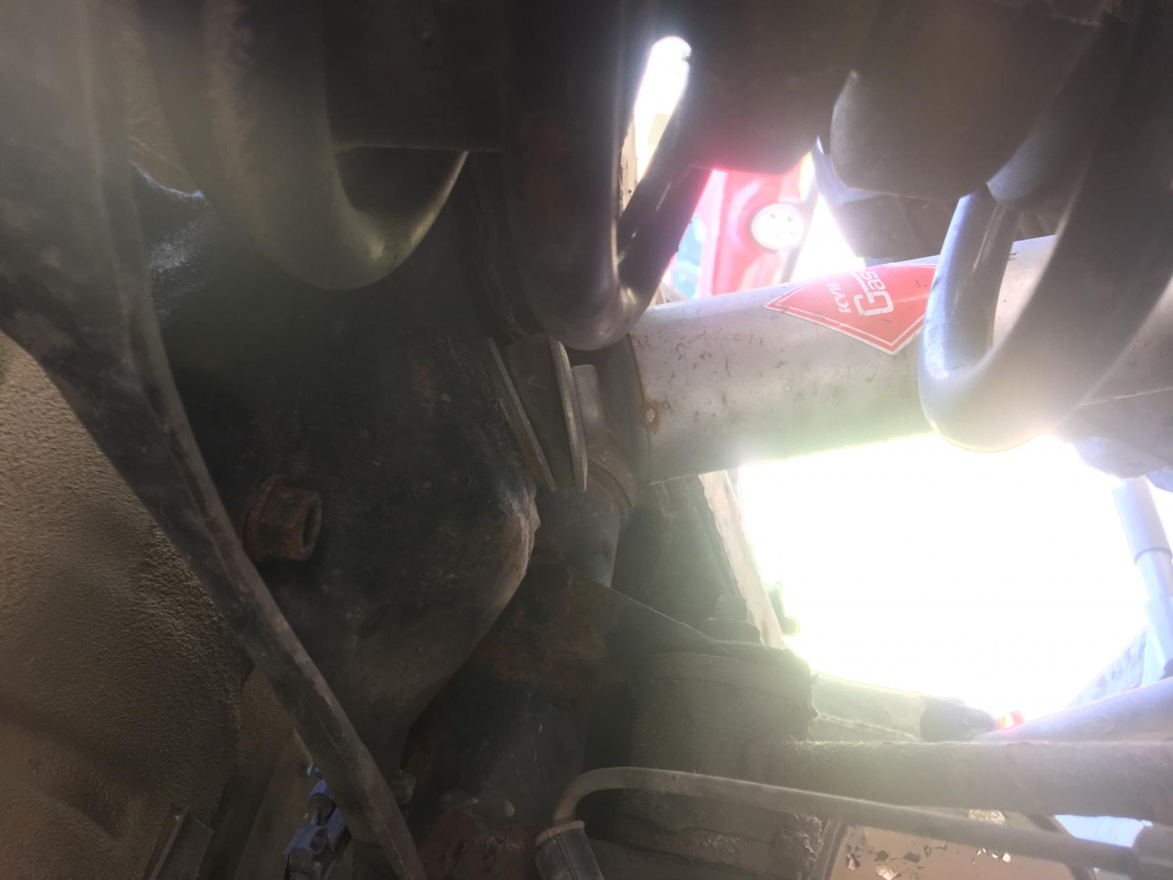

I just jacked mine up until my coil was loose enough to fall out and it looked similar to what your showing with the dobinsons shock so I’d say you are good.
