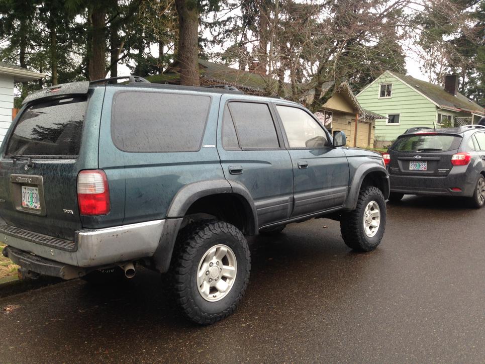

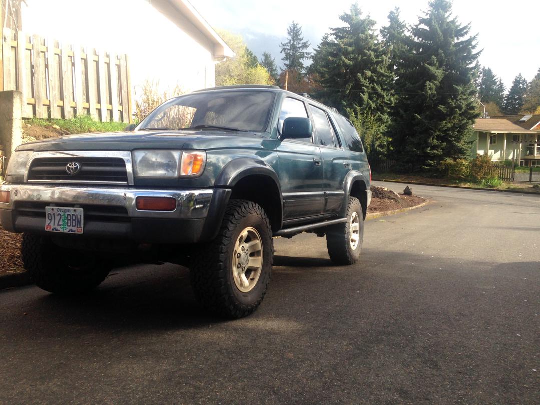

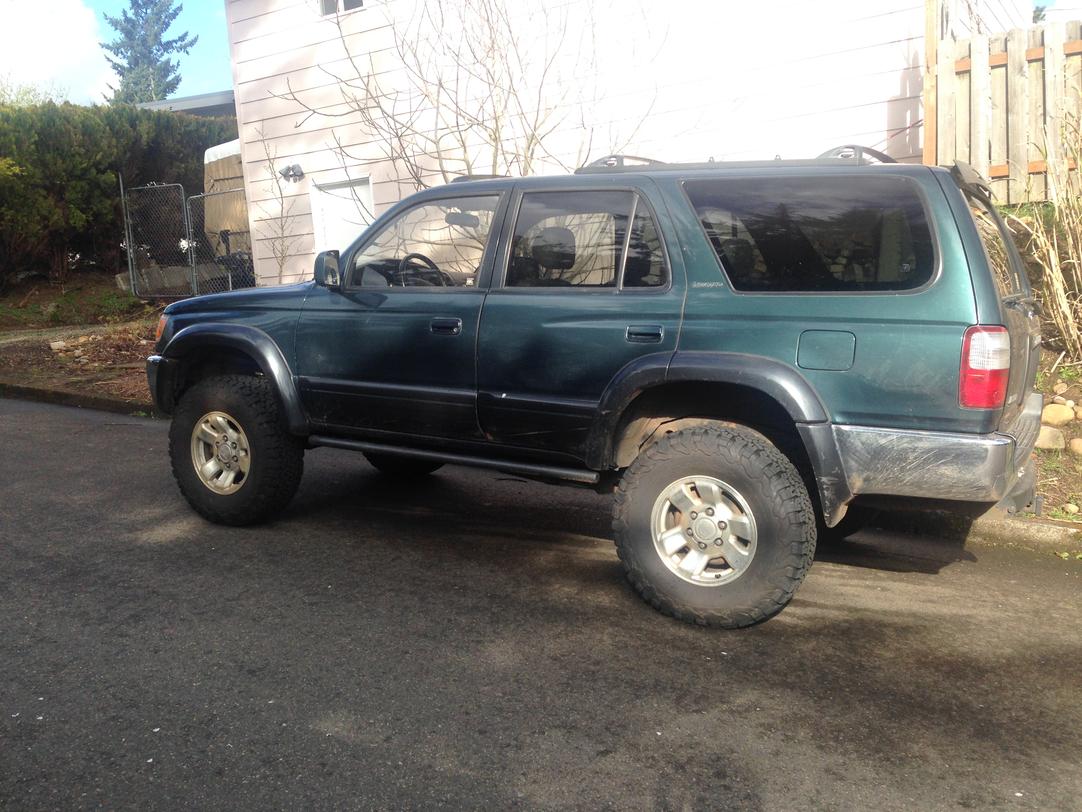

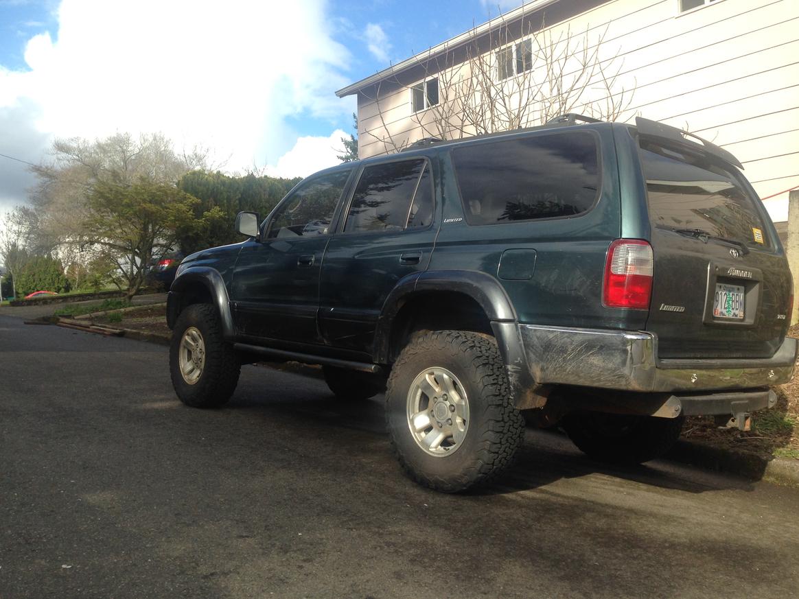

OME 881s with Bilstein 5100s (lowest perch) up front and OME 890s with Rough Country N2.0 in the rear. A little over 3" up front and 3" in the back on 265/75/16 Ironman All Country A/Ts. Personally like the look of 285s better but my T4R is my daily so. :biggrin1:
Thanks!
More angles please :biggrin1:
I apologize for my iPhone quality photos and inept photography skills. You can also get a peak at my terrible car washing skills. In my defense, it was dark out and I was mostly focused on the caked on mud
What front perch are you on? This confirmed that I want this exact setup with LC shocks in the rear though.
I have Tundra 5100s and I am on the first, lowest perch. In the rear, I'm using Bilstein 5100 part# 33-187174. They are recommended by Toytec for the Superflex coils, and I believe they are also the same Bilsteins that are an option for the SS 1.2 kit. Wheeler's Offroad has them listed as 07-09 FJ Cruiser shocks.

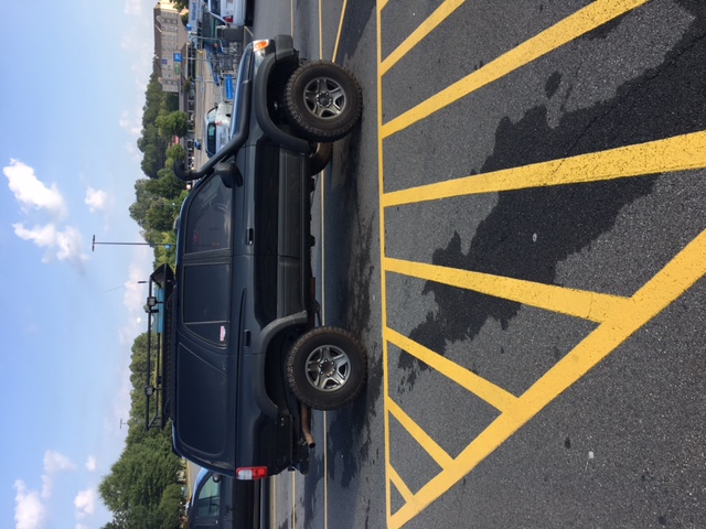

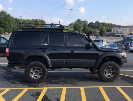

Thank you looks great!!

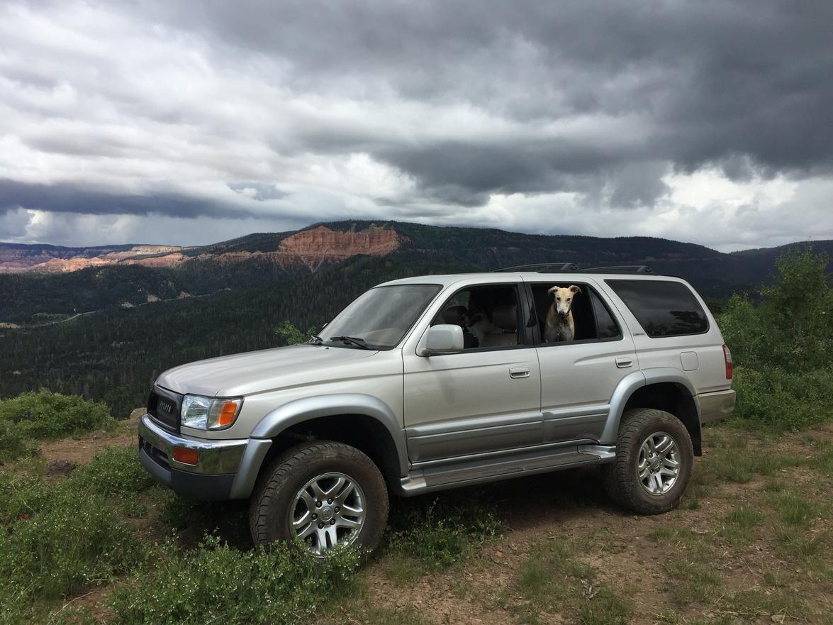

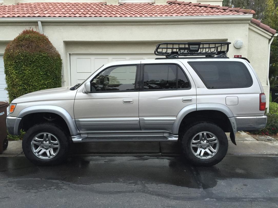

Toytec/eibach springs up front with tundra bilsteins on lowest perch, land cruiser 8.something wrap springs in the rear, 265/75/16 Hankook Dynapros
best_campsite_zpscbcb8340.jpg~original
side_zpsf129a857.jpg~original
I am looking at getting this exact set up as yours and these pictures look sexy so, have you had any problems with it and how is the rake? Also your tires look pretty balanced to size with the lift what brand are they?
No problems with the lift at all, rake is significant now though with front bumper and winch. I think I was running Goodyear Silent Armors in those pics but that was a while ago, Duratracs now.

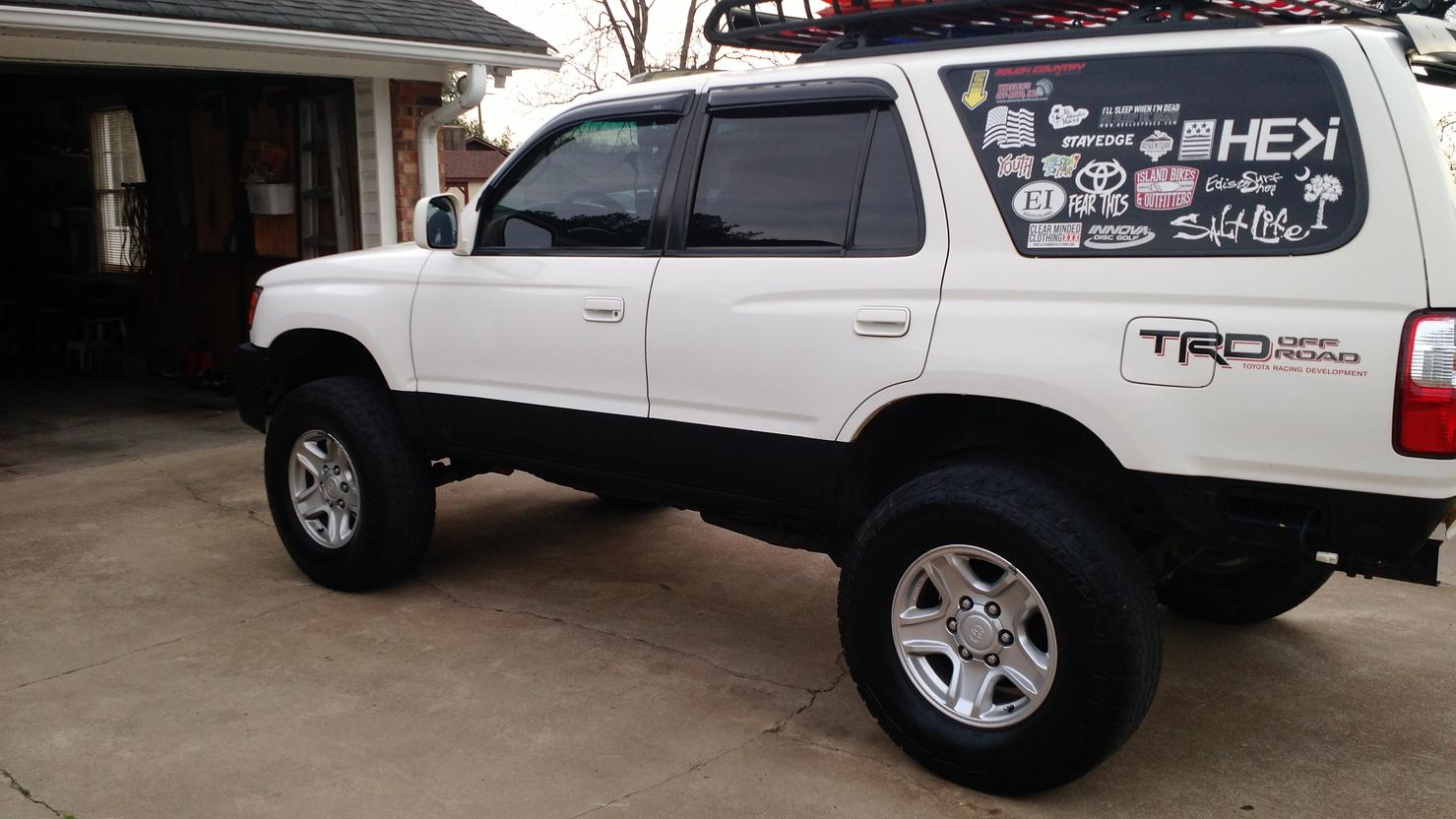

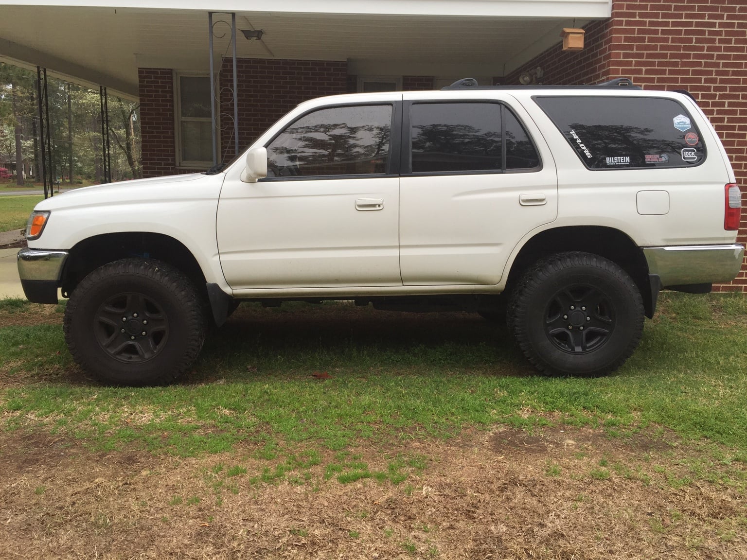

Some old pics of mine fit what you are looking for. I liked this set up.
265/75R16 Duratracs with 2.5/3 inch lift coming from OME 881s in front and OME 890s in the back.
Beauty. I know this is an older post, but are you using wheel spacers in this particular setup?
My 4Runner currently has 285's on the Limited 16" wheels (w/ OME 881/890 combo), but previous owner put Wheel Spacers in. Although the stance is nice, I would like to eventually ditch the spacers when I get some new rubber. I'm thinking of downsizing to 265's for this purpose.
I have a high speed wobble and suspect that it could be the wheel spacers which I'd rather not have. I dunno.
