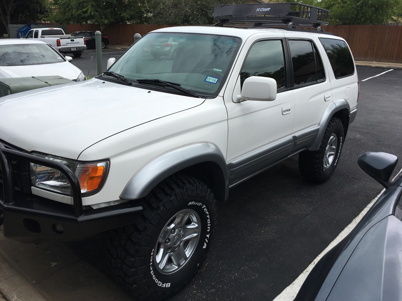

Same truck for everyone, how come same lift and tires size look completely different? This is hilarious. Some are wrong for sure

Some of your tires look bigger because I am on 3" lift on 285/75 r16 and mine don't hug the wheel wells any more that some of yours do.

There are a few different things that can change how a 3" lift ends up looking. Mainly, the offset of the wheel used as well as the type of tire. A rig with a 3" lift, wheels with a wide offset and aggressive 265 mud tires will look a lot different than one on a narrower offset and street tires.
I have to educate myself on the offset, I'm not clear on that. Some say spacers, others say you don't need it if you have enough offset...
