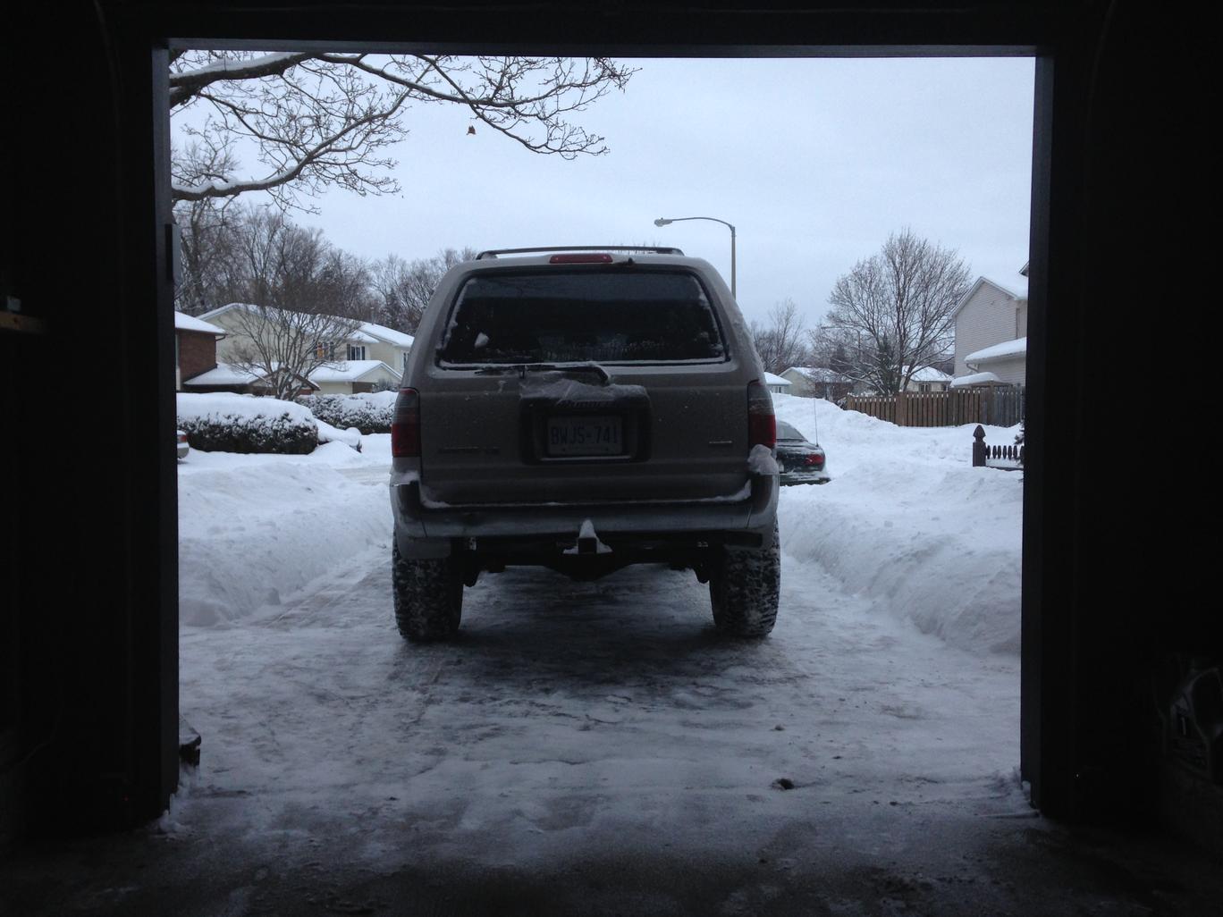

Is this what causes the driver's side to sit lower than the passenger side? My rig suffers from this. The previous owner is the one that installed the lift, I bought it this way and the driver's side lean has been bugging me. It's especially noticeable from the rear, some folks told me it was because the gas tank sits more on the driver's side and that's the cause of the lean. More noticeable when the tank is full. I call bull on that one.
I've had two lifted 4runners. Without adjustable panhard bars, they've both had a pronounced driver's side lean.
Mycocobean could also be right tho, the PO could have installed the springs on the wrong side. I'd try the panhard bar first though and then if that doesn't fix it, pull the springs, measure, and then install the longer one on the driver's side.
First off, my apologies to [MENTION=71420]masphx[/MENTION] , I don't mean to highjack the OP's thread, but hopefully this helps you out as well.
As far as I've been told by my T4R's PO, this is what was installed.

The front end shot doesn't look that bad, but the rear lean is definitely more noticeable.

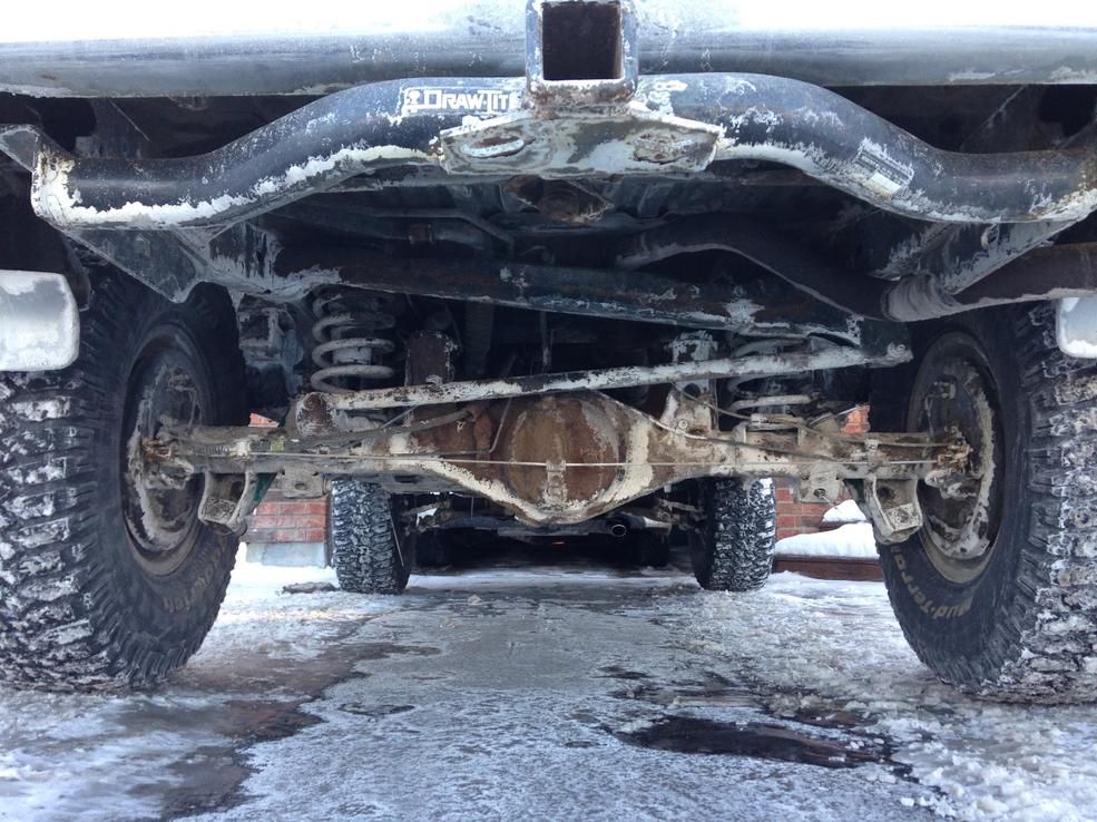

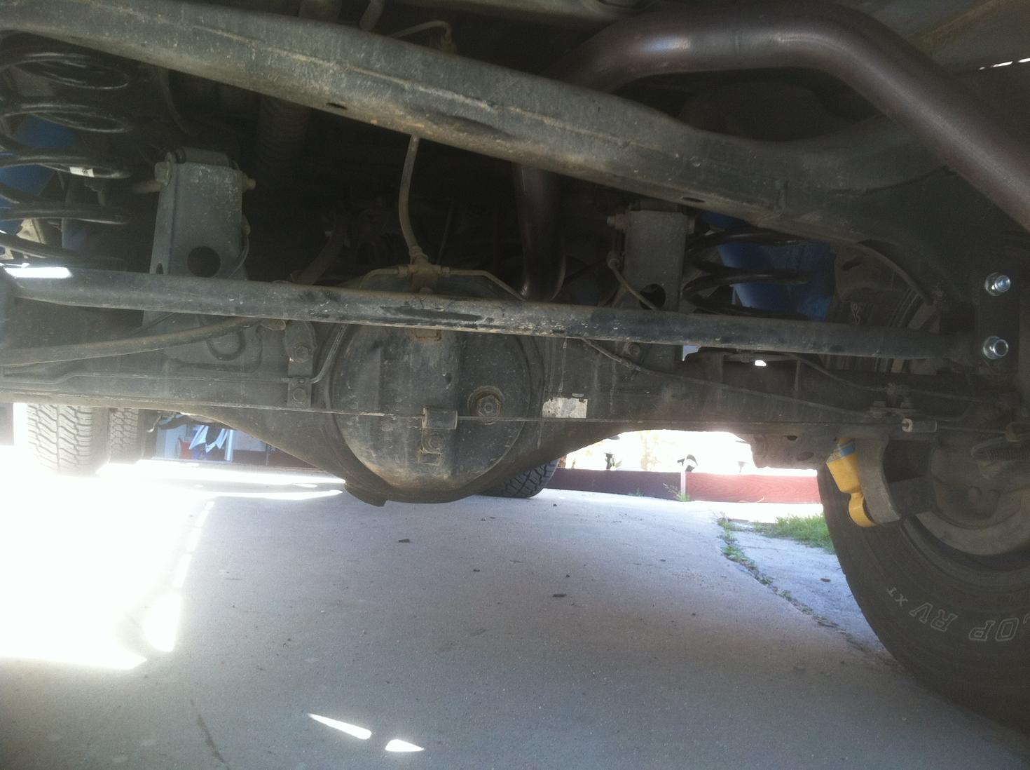

How is the angle on the pan hard bar in relation to your axle ? i found that rear axle was off center after i lifted my truck by about a 1/4+ inch .this could be felt when driving on roads with a lot of crown. it was like the rear end was searching or giving busy side to side feedback at the wheel .ended up going with toytec's drop bracket and it was a noticeable difference on how the truck handled .

Well just to give you an idea .i think the more parallel it is with your axle the more it will work as intended
