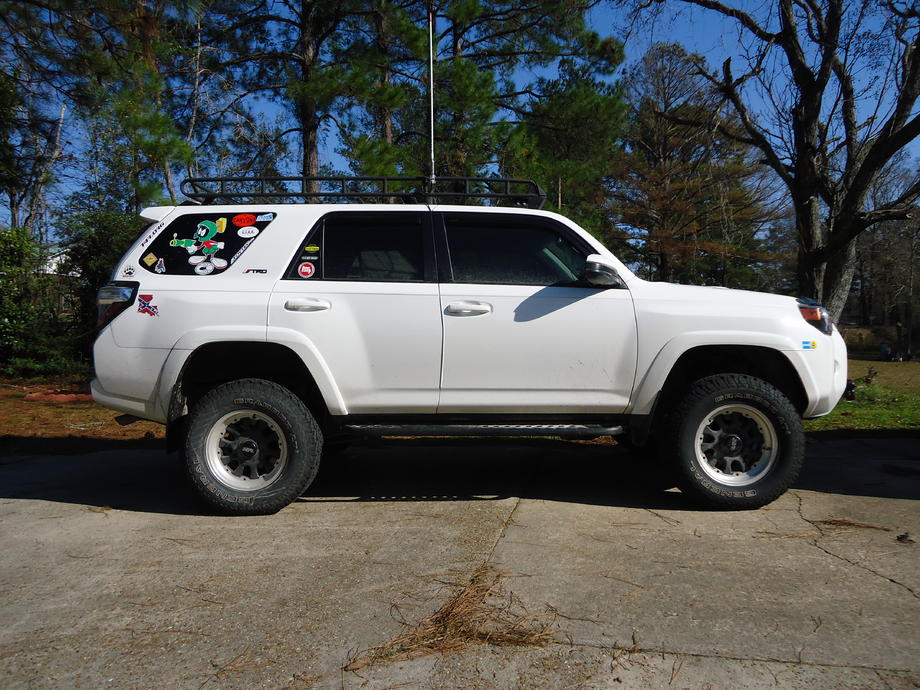

I'm still rocking 265's at 2" and have no intention of upsizing in the near future. In fact I just bought my 2nd set of tires this year. This is pre-Bushwacker and CBI bumper from early last year.

Thank you for posting the picture. This is exactly what I needed to know.

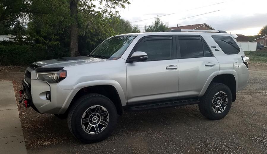

I am more interested in the function of the vehicle rather than just looks, but I personally think it looks fine. Most people that see it and comment on it think so also.
