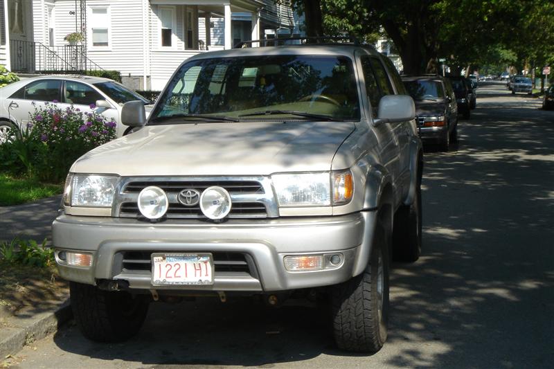

and i read on some bl writeup that a 1" would be enough for 33s. does anyone have a picture of a 4r with stock suspension and a 2" bl? i want to make sure it doesn't look to goofy
RooRRunner said:
haha if yall pay for em ill stick em on. is there a m/t option that has considerable on-road durability?
a ne4roc member has a 2"bl stock otherwise (incl tire size) -- see attached img
a 1" bl is NOT enough for 33's. i have a 1" BL with a 2.5" suspension to clear 33's.
