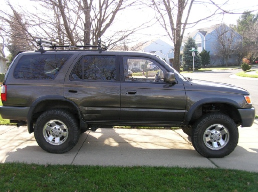

fixed lift pictures
this is 2 inch bl plus 3 inch suspension lift.
I suggest the toytec spacer lift and then get a 1 inch bl or if you want 2 inchs. no more though
damn thats sexy. that's the route i plan on taking once more cash becomes available. as for the cables i was talking about, i've been through over a thousand pictures so far on the net and only found one alright pic

Not exactly the picture you're looking for re: the body lift, but I just had 3" Revtek spacers installed. Ended up giving me 2" in the front and 1.5" in the back on 265/75R16. Looking at coils in the rear to level everything off.
