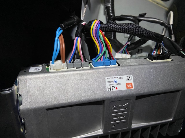

Thanks Bumbo. I did a little bit of digging today and the fuse shorts whenever I plug in the white plug (blue and brown wires) into the amp. I need figure out what those wires are and like you mentioned, see if it's the amp or the wiring. I've been searching the internet today to see if I could find an electrical diagram. So far no luck. I might take my car into Toyota Monday to see if they can help figure it out.

After reading a few articles about amp fuse blowing. The blue and brown wire is most likely the power wire. I'm going to have to trace these wires to make sure it's not grounding out some where. If the wires are good than it's the amp. Ouch!
I would prefer it to be the amp and not the wiring harness, which might be more costly to fix from a time/labor standpoint.
You can use a volt meter to measure power at the connector and you can test continuity to ground with a meter as well. Use the resistance setting and mark the value.
