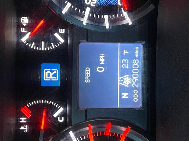

300 Coming Up
CutthroatSlam
Senior Member
2014 SR purchased new in September 2014. No OEM fluids used.

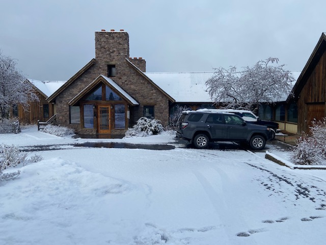

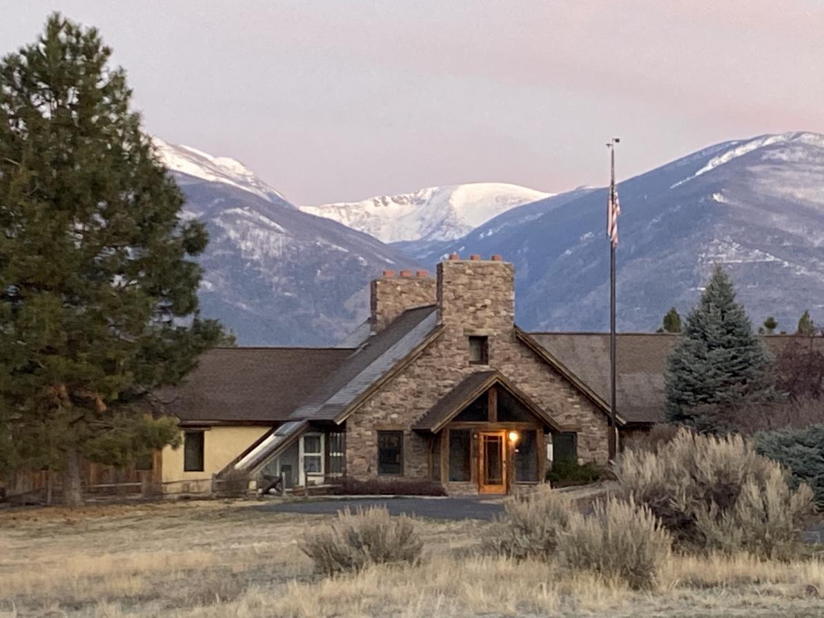

90% hwy, 10% off-road 4wd. Wife piles up the miles going between homes in SoCal and Montana (1200 miles). Also, she is an avid geocacher and drives all over, including off-road for that. She is older than me and retired. Myself, I'm still working.

Thanks for showing off. Toyota will continue to use the 1gr-fe and 5 speed for another 20 years because of this.
At my current rate of mileage accumulation, it will be 100 years before my 4Runner reaches that mileage. I don't think I'll be here...
Nice place.
