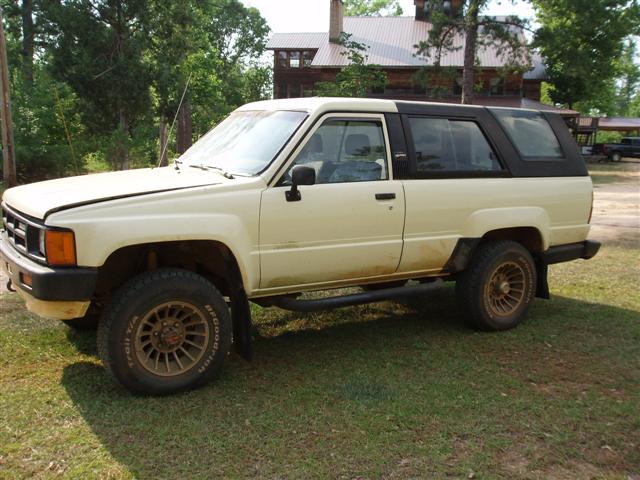

Trying to get picture size right on this post! First time for everything.
1985 stock with 150k on odometer. I've owned since 1986. About to undergo major upgrade. Little to no rust so figure I might as well keep it forever!
