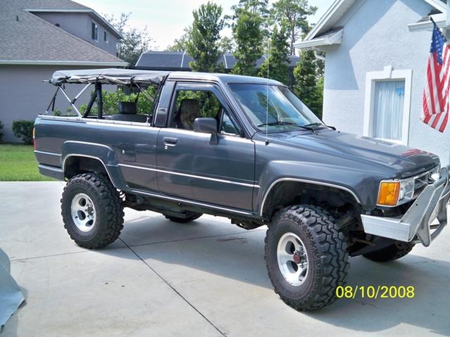

get a 2" body lift theyre cheap and then you can run the 33's
I've got the 2" body lift, and running 32's.
I did have some rubbing on the back, outside part of the front fenderwells at full lock.
A little hammering took care of that.
I also had to turn up the torsion bars a bit to raise the front some more.

I run 33s np with a 4in bracket lift. A small body lift can make those fit, or even a stock height rig with the pinch weld hammered in.
