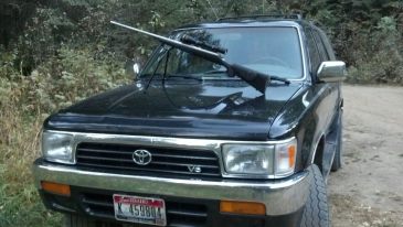

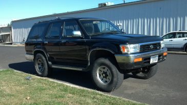

Lol sorry Ive been meaning to put some up...just got her a few days ago for 1800..170k sr5 5 speed few dents but pretty nice condition overall..love this rig so far, looks great and will be a great huntin rig( notice my rifle of the hood) They even match! ha

DAT ASS!
I agree with the others, that needs new coils, spacers won't help. You can either get replacement springs or do the OME coil lift. I have a 2in lift, nothing crazy but it looks good. What you'd be looking at is similar to FOG's (FootOfGod) truck. If i remember right he has a 2in OME with 33x10.5's i BFG M/T i think. Should be in the sticky at the top of our forum though. check it out.

With that amount of rear end sag, 33's are going to rub big time no matter how narrow they are. You new to get 2-3" above stock height to fit them.

Yup, with that much sag, you need new coils. Don't even think about spacers. The OME kit everyone is talking about will give you about 2" over stock and you will have no issue fitting 33's. You can get the kit all over the place. A simple google search will give you all the options. Check out:
