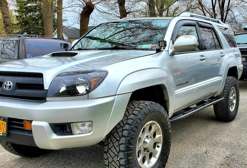

Otherwise with the v8 its moves them around just fine after proper trimming
