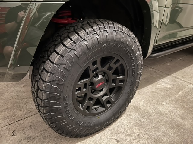

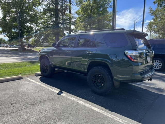

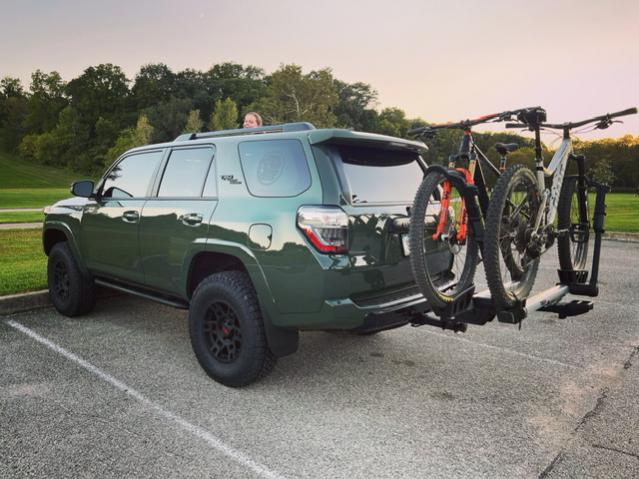

First thread here and wanted to share. I debated back and forth for months before deciding and didn't find much info on these.
Toyo lists them as D load at 55lbs. Measure 33.5x10.6 running small like the BFG version.
Best part, and my initial interest they are sub 300 to 315 unlike the BFGs over 450 a tire.
I debated back and forth on 255/80, 275/70, and 285/70.
Searching here and elsewhere couldn't find much on them so went for them. I got them 298/ea from simpletire and shipped to a local installer.
For reference, I do have TRD Pro shocks with Eibach springs for the Pro and a 1/4 top plate spacer. Put me right at 22.25" in the front up from about 20 before. Back is right about 24 with slight rake.
I also installed JBA arms and Pro wheels. I removed my mudflaps in the front in advance and did the fender liner mod as well.
Post balance and alignment (3 degrees+) I have no rub. It clears the body mount by about 1/2" and the tires clear the arms by about 1"
Gave the height and width I was looking for. I plan to put a 255/80 as the spare underneath to use as spare only
Here are a few pics. Also have a YouTube link discussing as well.
I like them so far. Obviously are more of a 33 than a 34 but drives fine with stock gears. Can feel it off the line some but not really once moving.

were toyo's online measurements of 33.6 tall and 10.6 wide precise?
Unmounted yes, pretty spot on. Mounted and with a load, more closer to 32.5-33
By far run small! Width on the pro 7” wheels is right around 10.5 though

Wow, this is very intriguing. I would love to see a few more pictures of different angles. Have you tried flexing it out yet to see if it rubs the body mount then?
I love the idea of this tire size because I'm a huge fan of running stock wheels and being able to clear the UCA without spacers is awesome.
Did you need to run and wheel spacers?
Negative. I had some on hand, but they tires cleared the JBA arms on stock pro wheels by about an inch. I was very worried it would run but don’t.
I think if I did through on my 1” spydertrax, I do think it may run on the body mount. It’s close as it is, so pushing it out I think it will hit.
So no, no spacers on stock pro wheels.
BFGs are notorious for running small so even though they say 34" I guarantee they are a "large" 33".
These are Toyo, but ya same story. Unmounted they were 33.5 to start. Mounted, about 33. And then on the vehicle with weight at 32psi I get right around 32.5” with a level.
So 34 becomes a 32.5 mounted under load. Definitely running small here as the BFGs did. But, knew that going in and ok with that myself. I don’t. Think they would fit as a true 34 without a BMC at minimum.
