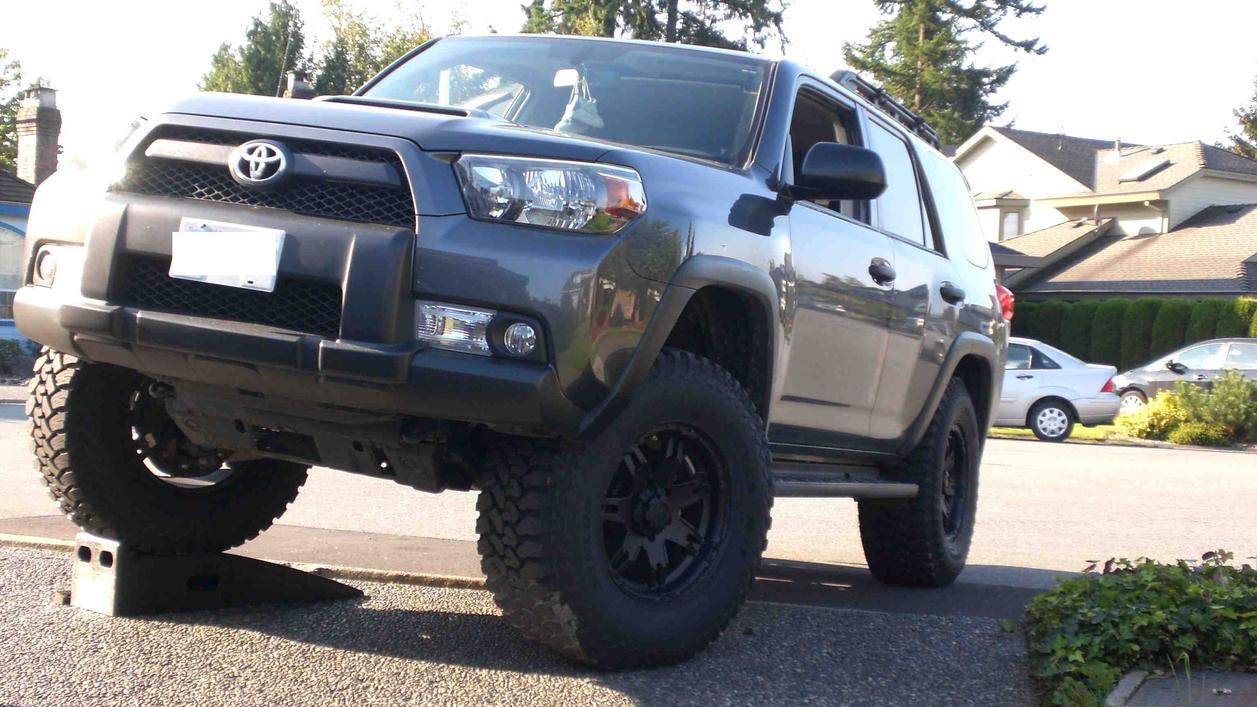

I got 34.5" Tires and the rub that occurs on mine is very minimal(i did do some fender liner trimming), i have 315/70/17 wit a 3" lift.
