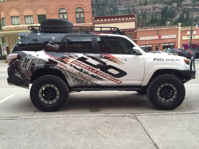

Check with Jason Demello. He might be willing to tell you what was involved in stuffing 35's under a 5th Gen. :cheers:

Anything that wide as in Demelo's picture just does not look proportional to me. Sure he fit them. But look how close the tires are to the fender flares? I bet he rubs when going up driveways at a 45 degree angle. You simply cannot off road that thing with full stuff! Maybe you can if you ware earplugs so you dont hear the tires rubbing on everything..
Any 35" tire on the roof rack? How the heck do you get a tire up/down there that big by yourself? You simply can't!
