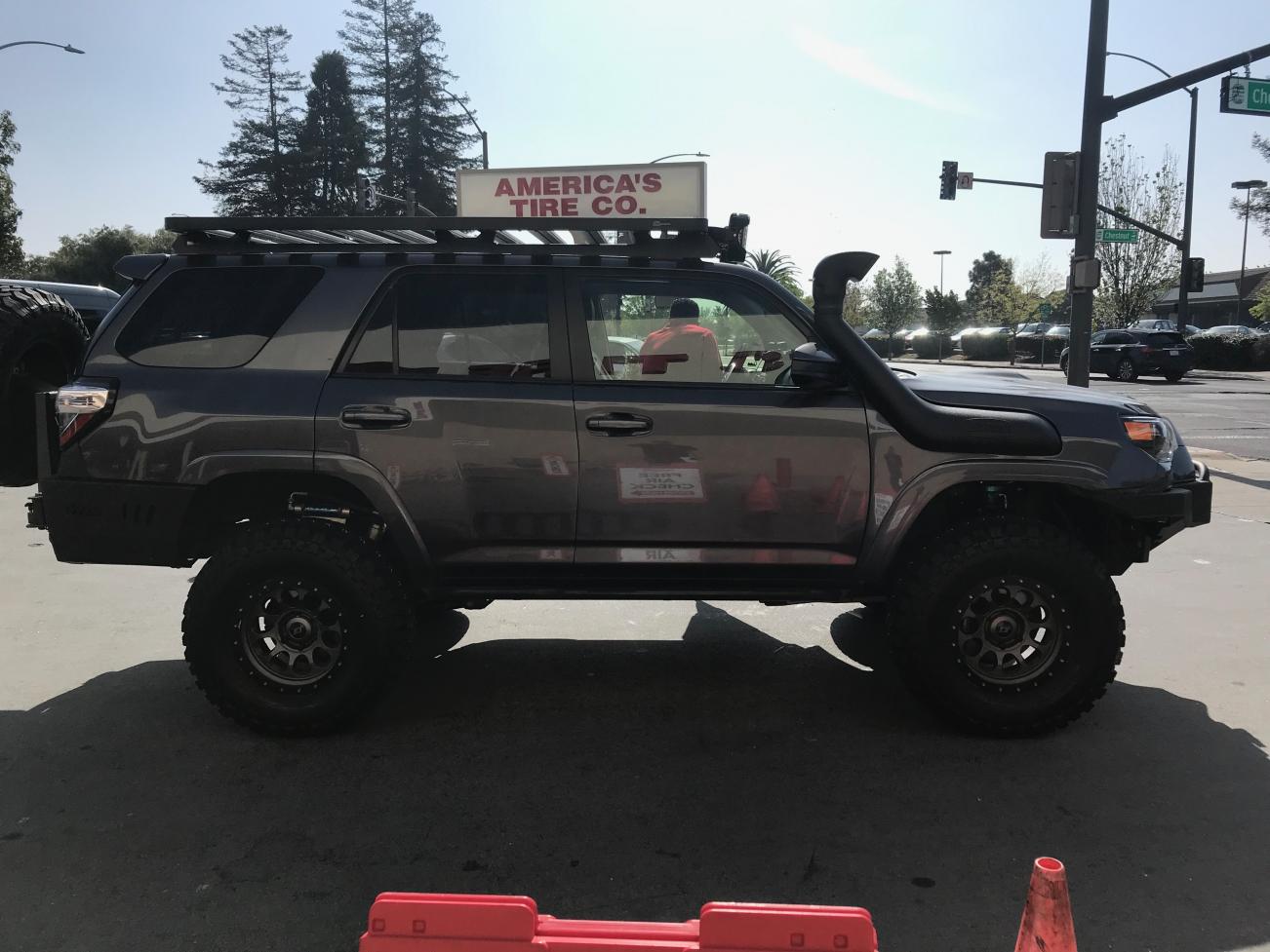

Falken Wildpeak MT01 35x12.5x17 on 17x8.5 SCS Ray10's.
(sorry crap pic I know)

Did you have to lower your bump stops? If so how far?
Yes sort of...in the rear I have Timbren's, which are pretty tall bumpstops. They were about the same length as what I had before, which was the toytec bump stop spacer with the stock bump stop in the rear. In the front, I used Wheeler's superbumps, which are taller than stock.
