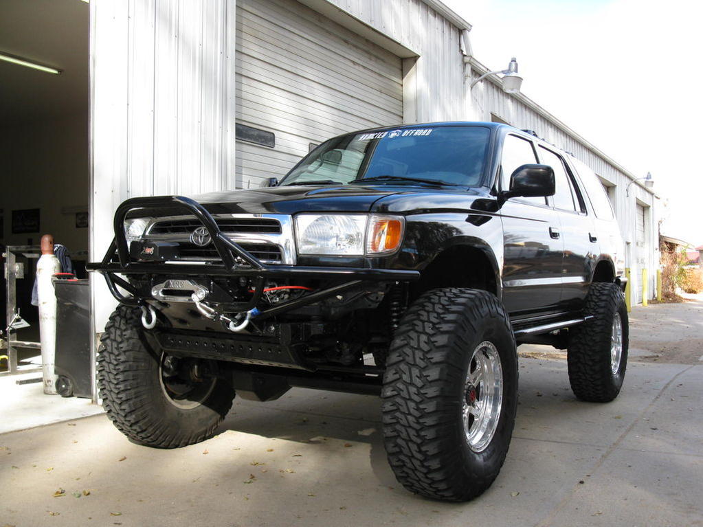

The Addictedoffroad guy has about 4" total lift on 37's. Here is a pic of his T4R.
Yes, still has only 4" total lift. For someone wanting to run such large tires, swapping too solid axle wouldnt be too far fetched.
Completely different. With the SFA, Scotty was able to move the axle forward so it would not rub on the rear of the front inner fender. With IFS, the tires always rub in that location since they sit further back in the wheel well. You can't just push the suspension forward like you can with a solid axle.
