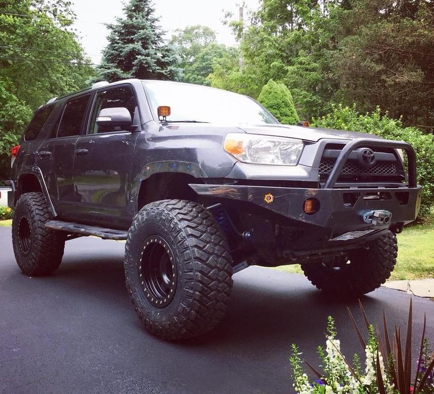

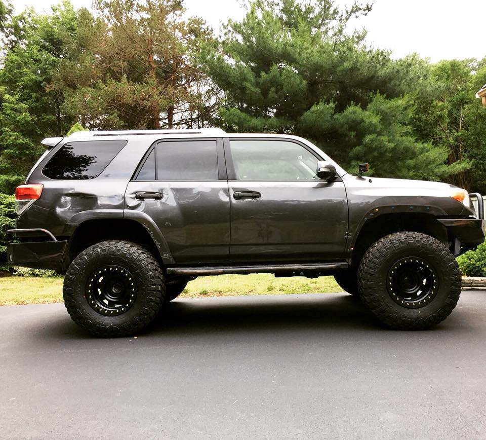

It's hard keeping up with buggies/truggies and Jeeps on 40s almost every weekend. Threw on some new beadlocks and 37s.

I think it might be time for a trail rig.. Just saying.... My 5th gen would be a total loss if I tried to keep up with the rigs I wheel with in my pickup.
If you don't mind having a raisin.... I guess keep up the good work LOL
Jesus, here I am worried about the swirls from quick detailer... .
Just DM me your address so I can mail you my man card.
Most definitely the hardest wheeled 5th gen I've seen, forum and IG included.
Wheel hard, break things, rinse and repeat. Plus it's an SR5 too!
Hats off to actually using it ( I thought mine was beat up!)
But I will say I think 35's are the visually appealing limit for me those 37's start to make things look odd - clearly visual appearance is a top concern when choosing to run 37" tires :bowl:

It is my trail rig.
Id be interested to know what you did to make it trail worthy with 37's. For me it was cut the footwell back 2" and re-plate, move the rear axle back 2" along with a new driveshaft, trim and beat the crap out of both inner fenders and plastic body parts, more lift, extra bumpstop length....
Hit trails with friends over the weekend up in NH. The truck did great on the new wheel and tire set up. Slight rubbing in the rear. Steering rack hates it but I was able to keep the inner tie rods in tact.

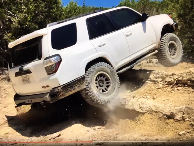

Finally got to 37" tires
Had to tub the front wheel wells (moved the body mounts and cut into the firewall). Relocated the window washer fluid reservoir and running +4 caster. Haven't bent a tie rod yet - had it offroad 5 times since installing the 37s.
